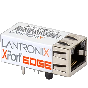

There are Ethernet controllers which connect via SPI (and other interfaces) - you could use them to add extra physical interfaces?
And there are things like Wiznet & Lantronix which offload the whole IP stack; eg,
https://www.carminenoviello.com/2015/08/28/adding-ethernet-connectivity-stm32-nucleo/
https://www.lantronix.com/products-class/wired-modules/
