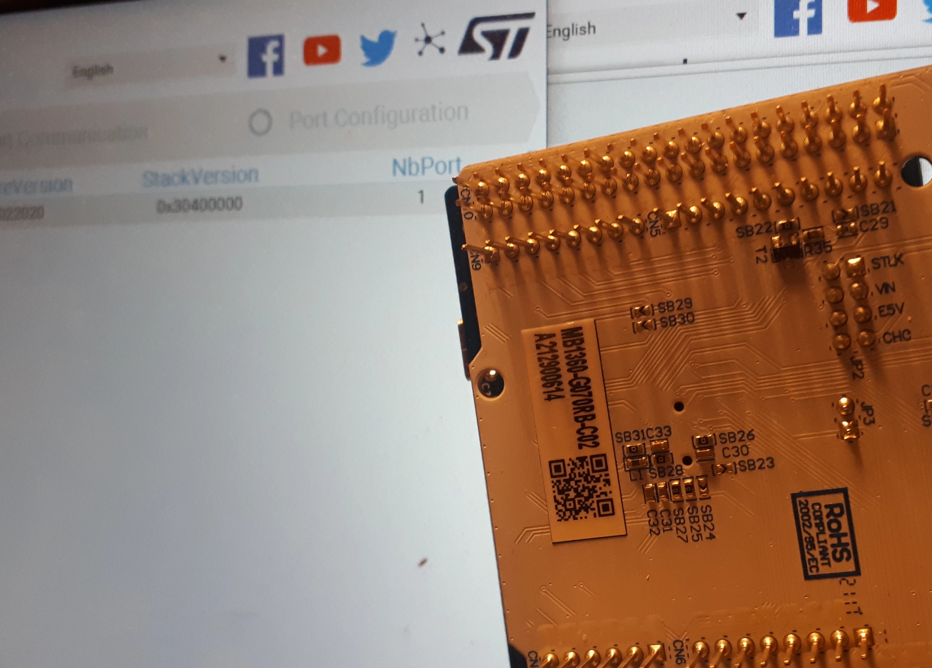

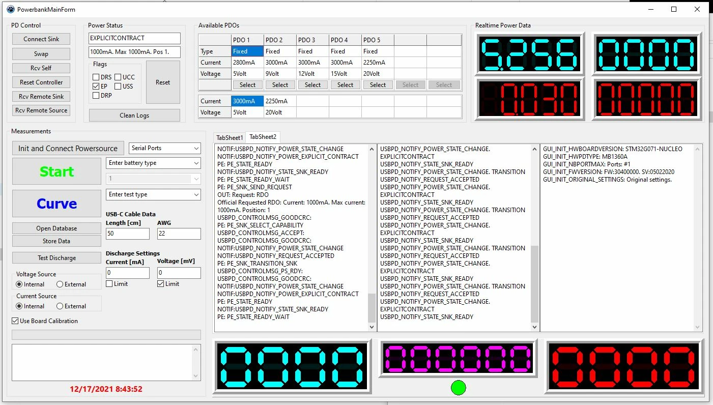

AlfredoAuthor
Dec 16, 2021 6:50 PM UTC
Board: G070RB. With G071 firmware.
Connected with Cube Monitor. Working flawless.
Very strange.

Alfredo
