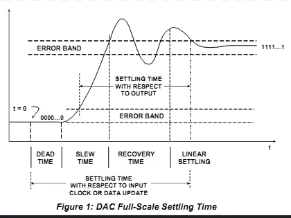

The DACs are
So driving them faster than the given settling time produces no "error" , just the output signal quality gets worse.
Only after settling time the output is at its final value, so driving it faster is no problem,
but signal is not as good any more.
The best qualtiy, as given in ds, you get by driving them at the max. speed, or slower.

I don't think it's a physical limit, in terms of gears grinding, just that it lacks the dynamics / bandwidth to slew at higher rates.
So there's not going to be an error or status flags. It's your responsibility to get the factoring right in the TIM dividers, and keep it within range, and matching the sample rate of the data. If you saturate the DMA, then you might expect to see over/under flow type errors.
>>Am I correct in assuming it's just ignoring those extra timer triggers?
No, that would be an incorrect assumption.

For the G431 the datasheet says:
• 4 x 12-bit DAC channels
– 2 x buffered external channels 1 MSPS
– 2 x unbuffered internal channels 15 MSPS
So for the G431 it looks like it is an analog limitation, and should not be a problem to drive the DAC with the 2.x MSPS, as long as the signals are actually not changing to fast to cause problems for the analog output buffer.
