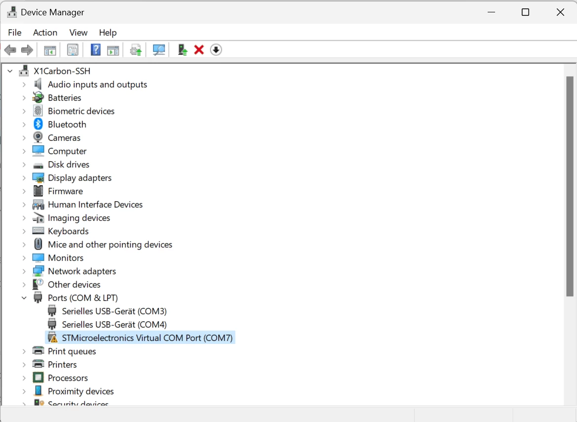

Dear Community,
I keep getting an error message when installing the latest STM32 virtual com port driver on both Windows 10 and Windows 11 - can anybody suggest a solution?

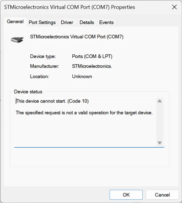

Hello @SSchu.12​ ,
Try increase the heap and the stack size or configure the USB library to use static allocation.
I invite you to follow this FAQ related to the problem "USB device not recognized":
Hope this helps you.

same problem are there adapter drivers?
Pavel A.
Dec 15, 2023 10:29 PM UTC
@MwF2DD Modern versions of Windows, Linux and OS/X have in-box drivers for USB CDC/ACM devices (aka "virtual COM ports") so users don't need to install any custom drivers. Devices that are not of CDC/ACM class, such as FTDI,  require custom drivers.  Windows 8 or older is not supported any longer, with these versions you are on your own.
