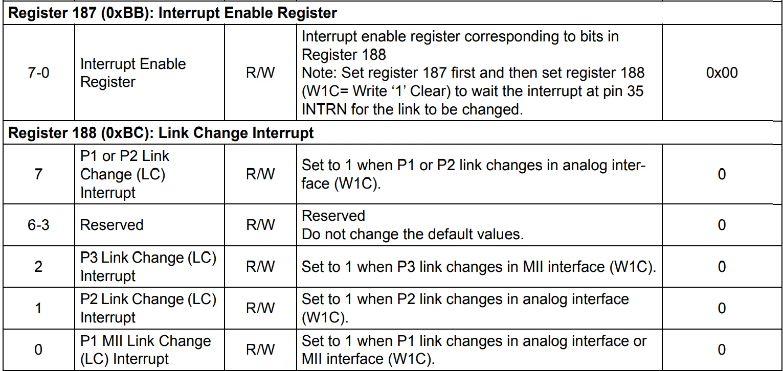

MOtto.2
MOtto.2Author
Feb 25, 2023 3:33 PM UTC
Hi thank you for reply,
I have digged in the manual of that switch and found out that it's posible to set some interrupts upon link change of certain ports. Does ST makes it easy to read&write to that registers via RMII. I have that INTRN pin with no use right now might consider changing that.
Pavel A.
Feb 25, 2023 8:30 PM UTC
Through RMII you can accesss 32 registers. Other registers require connection through other interface, I2C or SPI.
