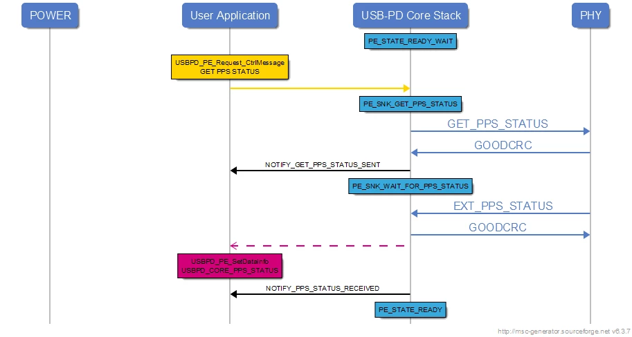

Yohann M.
May 7, 2020
Dear Alex,
No only request is automatically sent by the stack (this is mandatory by the specification, refer to definition of tPPSRequest timer, "Request Message requesting a PPS APDO is sent periodically as a keep alive mechanism").
It is up to application to send a GET_PPS_STATUS message. Yes you can trigger it through the API 'USBPD_DPM_RequestGetPPS_Status'.
You should be informed by the PPS_STATUS through the notification 'USBPD_DPM_SetDataInfo(USBPD_CORE_PPS_STATUS)'.
Please find a Message Sequence Chart linked to this scenario:
Regards,
Yohann
