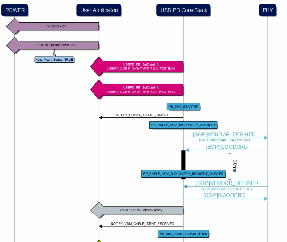

Dear @ADoro.2​
I confirm than STM USB-PD core stack supports EMC cable.
Please find the associated Message Sequence Chart:
The option '_VCONN_SUPPORT' should be enabled in your workspace.
With this switch, "DPM_Params[PortNum].VconnStatus" variable is set to USBPD_TRUE and will be used to activate VCONN and start VDM negotiation on EMC cable (VDM Discovery message).
You could refer to demonstration code on STM32G081B-EVAL board to see where this flag is enabled:
https://github.com/STMicroelectronics/STM32CubeG0/blob/master/Projects/STM32G081B-EVAL/Demonstrations/DemoUCPD/
This activation is necessary to enable VCONN on the CC line used to power on the cable like this
https://github.com/STMicroelectronics/STM32CubeG0/blob/master/Projects/STM32G081B-EVAL/Demonstrations/DemoUCPD/Src/usbpd_pwr_if.c#L441

Cable ID information will be retrieved thanks to the callback in usbpd_vdm_user code:
https://github.com/STMicroelectronics/STM32CubeG0/blob/master/Projects/STM32G081B-EVAL/Demonstrations/DemoUCPD/Src/usbpd_vdm_user.c#L760

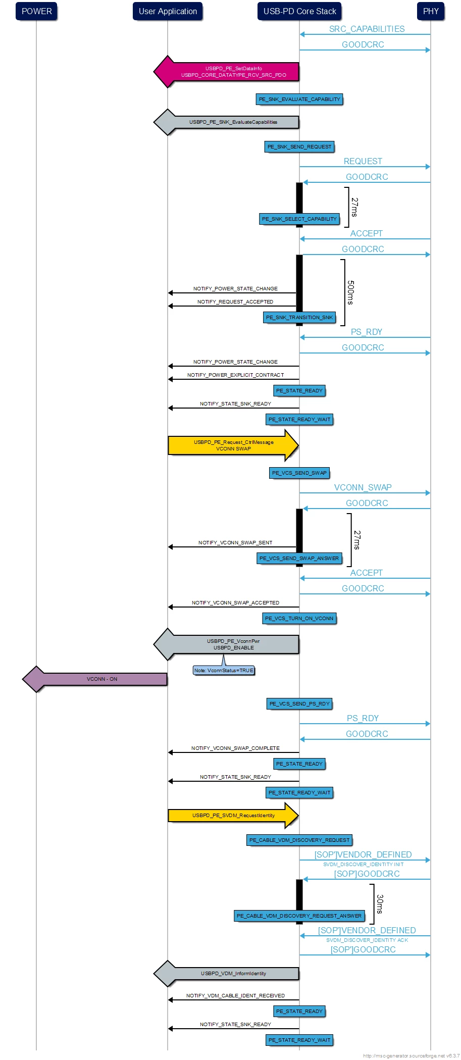

But I have a couple more questions.
  1. Is it possible to identify EMC if it is only connected to the Source, and nothing is connected to the other end of the cable?
  2. Is it possible to identify EMC in Sink mode?
Yohann M.
June 10, 2021
Great to see I helped you to fix your issue...
No, it is not possible to detect an EMC in Sink mode. Solution is to request a VCONN_SWAP to be able to start a VDM negotiation with the cable.
Please find a example of Message Sequence Chart:
Regards,
Yohann
