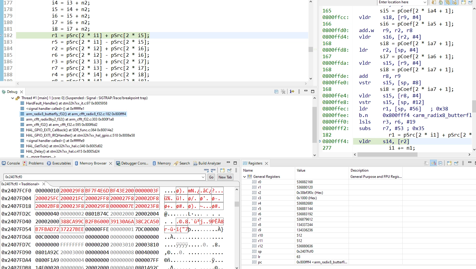

We have random HardFaults on an STM32H750, maybe after several hours of uptime.
It seems caused by an access to a wrong RAM location, whose address is fetched from the stack and stored in r2.
But the stack seems OK.
This happens in a function frequently interrupted by a higher priority HAL DMA callback.
Inspecting it AFAIK registers r0-r3 are not preserved by GCC optimized at -O2.
It could be that sometimes this interrupt takes place between loading of r2 and its use, overwriting it with a wrong value.
Inside my callback function there are calls to other functions. Is this OK? I read somewhere that GCC saves only the registers it uses in the main function of the ISR and doesn't take care of register's use in called function. Don't know if it makes sense.
Adding __attribute__((interrupt)) does not seem to make any difference.
For now I added push and pop of the scratch registers in the callback and it seems to work, but I'm not completely sure because a slight timing difference could be enough to mask the problem.

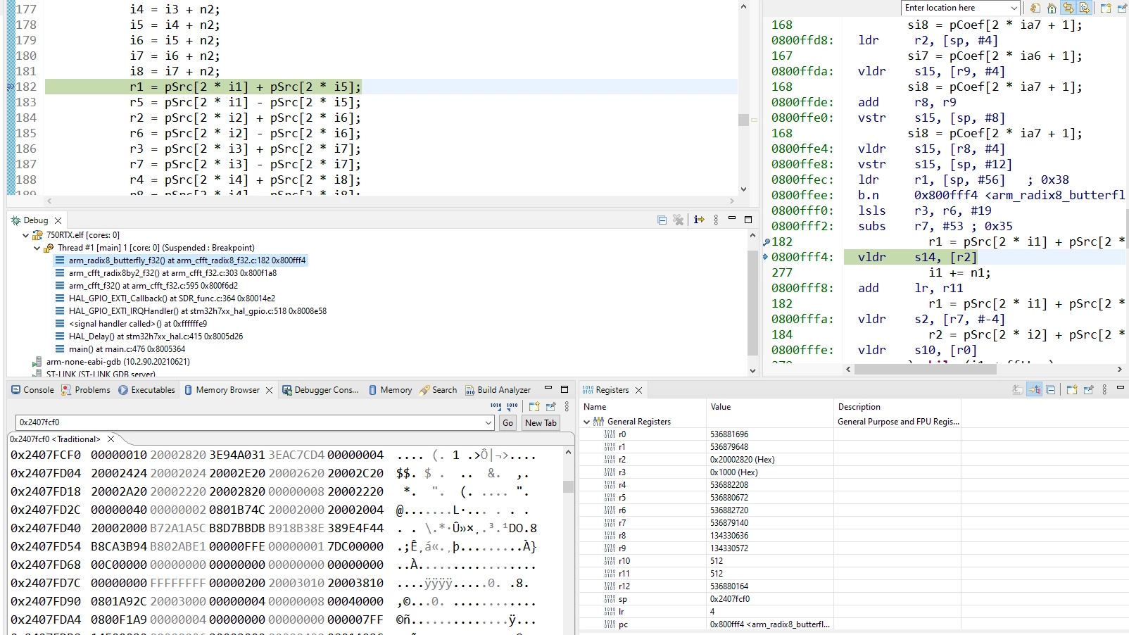

For now please have a look at these screenshots, The first is after placing a breakpoint on the one and only line that sometimes triggers the Hardfault.
The second is taken after a Hardfault. As you can see sp is the same, the stack looks OK, r2 is loaded at 0x0800ffd8 but something happens before reaching 0x800ff4.
Since r2 is, as brilliantly pointed out, automatically saved in ISRs, the only way to achieve this I can imagine is that in some way there is a jump from somewhere landing exactly there, and the ldr r2 line is never executed. Hard to believe because, apart from this hardfault, the board performs normally, and by patching with push or shuffling the code it runs forever.

I don't understand the second screenshot: is this something resulting from "walkback"? I don't use Eclipse. Show us content of registers, stack, disasm at the hardfault.

The second screenshot is from Eclipse indeed. It should bring the infos you are asking for. If you need a text file format let me know. Yes, I walked back to the hard fault context by pointing its line in the stack call view, center left. The important thing anyway is that r2 changes value without apparent reasons and triggers a hard fault while executing vldr s14, [r2].
Most promising hint is about cache. I would expect a corrupted stack and this is not the case.
Another thing I'm going to try is to disable interrupts during the CMSIS fft that gives trouble.
