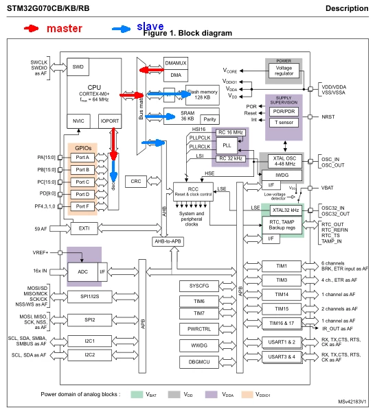

I can't get TIM1 to trigger DMA in my code (main.c)
Am I missing something?

Hello @TEl B
Did the DMA transfer work without TIM triggering?

Jul 14, 2025 12:53 PM UTC
Yes

waclawek.jan
Jul 22, 2025 8:37 AM UTC
In 'G0, GPIO are connected to the cpu-private IOPORT bus, not accessible from the rest of the chip, i.e. DMA cannot access GPIO in 'G0.

Jul 22, 2025 10:20 AM UTC
Thank you very much.
Writing to BSRR or BRR register is also impossible?
waclawek.jan
Jul 22, 2025 12:14 PM UTC
No that path is not possible.
That diagram is simplified in the fact, that the matrix consists of masters and slaves. Only master can initiate a transfer, providing address and direction of transfer and actively produce/consume data; and only slave can passively "consume" or "produce" the data of that transfer according to the address and direction provided by master. In other words, while the double-ended arrows do indicate the bi-directional flow of data, they don't correctly indicate the unidirectinal flow of address and control.

Thank you very much for your remark, you got me thinking.
I'm going to drive the WS2812B lamps with multiple parallel alternate outputs. One alternate output was already working.
