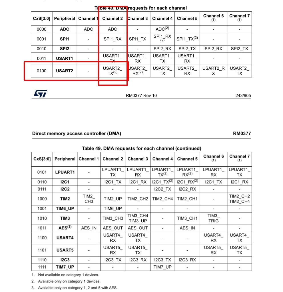

DMA on STM32L011F4
I'm trying to program an STM32L011F4 to transmit data through USART2 by way of the DMA controller.  My code compiles but the IRQ handler for DMA is never called.  Either I have not correctly initialized the DMA controller or there is another problem I am overlooking.  Can anyone provide suggestions?

You have to set DMA_CSELR.C2S = 0b0100 to map the USART2_TX request to DMA1_Channel2 (your STM32 model is Cat.1, right?)

waclawek.jan
Nov 12, 2024 6:31 PM UTC
How do you know?
Where does the PC end up, isn't it some default handler?
Read out and check/post content of the DMA registers.
Check the interrupt vector table in disasm.
Generic "interrupt does not fire" checklist here.
waclawek.jan
waclawek.janBest answer
Nov 12, 2024 6:41 PM UTC
Archadious
Nov 12, 2024 7:59 PM UTC
That was it, the code now works correctly.  Thanks for pointing out what I had overlooked.
I had read that section of the manual several times but thought it wasn't required because I was transmitting and not receiving data on the usart.
