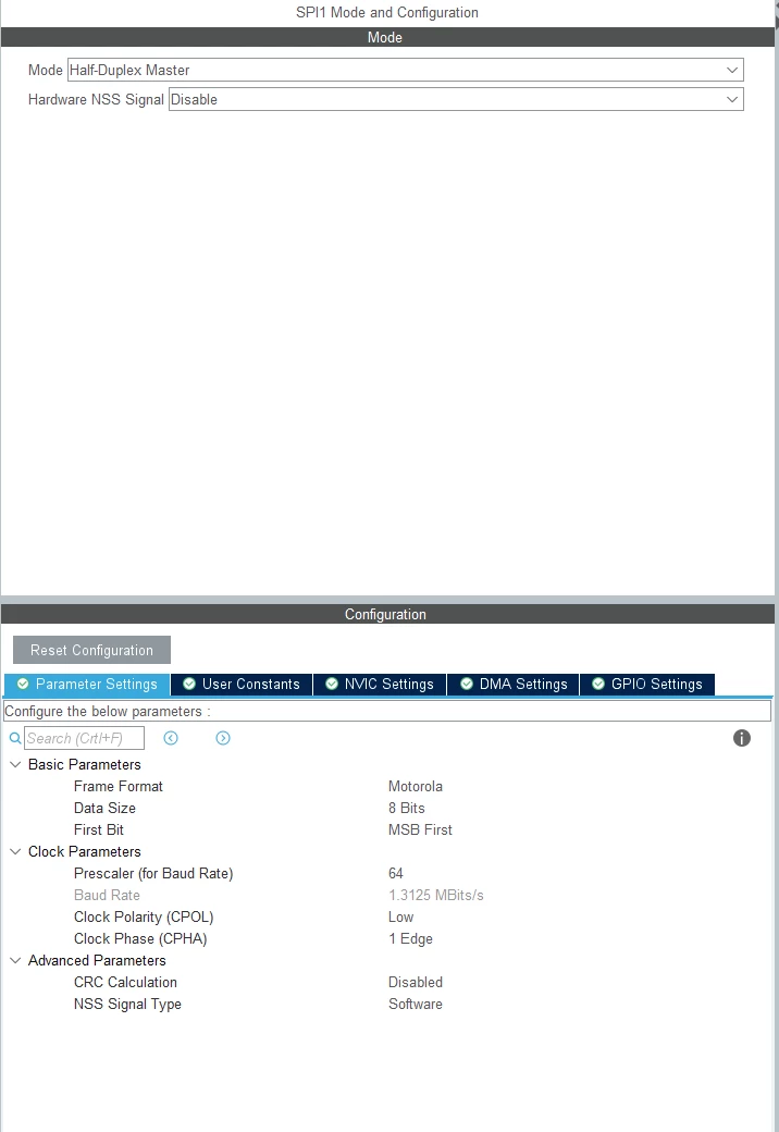

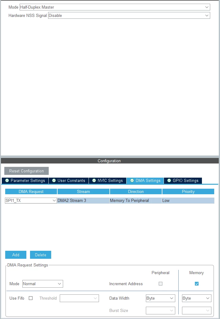

DMA on SPI
I've been trying for a while to get DMA working on SPI, it returns an error when i poll the DMA so it stays in the while loop but I can't seem to figure it out and there is not much Info that helps me. Maybe someone can help me to get it working, my code is below and HAL settings are below.

 uint8_t buffer[] = {0xEE};
 HAL_StatusTypeDef stat = HAL_DMA_Start(&hdma_spi1_tx, (uint32_t)&buffer, (uint32_t)&SPI1->DR, 1);
 while(HAL_DMA_PollForTransfer(&hdma_spi1_tx, HAL_DMA_FULL_TRANSFER, 100) != HAL_OK)
	 stat = HAL_DMA_PollForTransfer(&hdma_spi1_tx, HAL_DMA_FULL_TRANSFER, 100);

Foued_KH
Foued_KHBest answer
Sep 8, 2023 3:24 PM UTC
Hello @Hesseltjuuh ,
Try to use HAL_SPI_Transmit_DMA() function and let me know if this resolve your issue ?

Sep 8, 2023 3:39 PM UTC
It worked, amazing!
