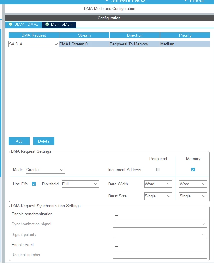

hi,
I am using stm32h743zit6.
I am having problems with DMA in my code. First i have a code that is not mine that takes data from a peripheral (a microphone) using SAI and then via DMA inserts this data into an array (a buffer). To do this memory is modified to do this.
I am doing the same configuration in other code to try to do this, in the original one the data refreshes automatically and in my own code, it just takes the first read.
ALIGN_32BYTES (int32_t __attribute__((section (".dmapart"))) dmaArray[data]);
HAL_SAI_Receive_DMA(&hsai_BlockA3,(uint8_t)* dmaArray, (uint16_t) data);
All the GPIO is ok because i just copied the same code. SCB_EnableIcache() is written in the main..., I don't know why is not  updating the data in my array and is working well in the other code. Anyone have any idea why is not updating in my code?
If any of you need more info about the code tell me please.
Thank you so much, i am desperating.

DMA -> in circular mode , for continuous data transfer. Did you set it to circular ?
rubenlesAuthor
Jan 26, 2024 9:24 AM UTC
Yes, it is configured as circular. @AScha.3

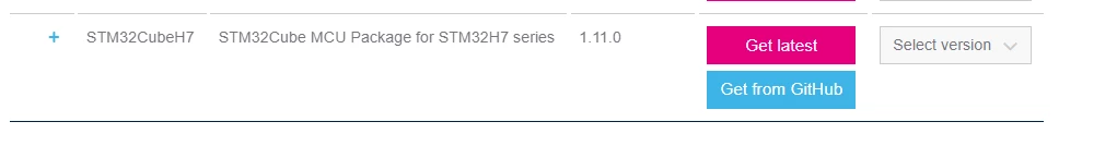

Sorry for asking it but, where can i find these examples?? I am looking for it and i didn't find anything
Thanks. @KDJEM.1
KDJEM.1
Jan 29, 2024 1:19 PM UTC
Hi @rubenles ,
You can download the latest version of STM32CubeH7 package from this link: STM32CubeH7 - STM32Cube MCU Package for STM32H7 series (HAL, Low-Layer APIs and CMSIS, USB, TCP/IP, File system, RTOS, Graphic - and examples running on ST boards) - STMicroelectronics
Then you can find these examples under these paths:
  • ....\STM32Cube_FW_H7_V1.11.1\Projects\STM32H743I-EVAL\Examples\SAI\SAI_AudioPlay
  • ....\STM32Cube_FW_H7_V1.11.1\Projects\STM32H743I-EVAL\Examples\SAI\SAI_AudioPlayback
Also, the SAI_AudioPlay example is available in this link STM32CubeH7/Projects/STM32H743I-EVAL/Examples/SAI at master · STMicroelectronics/STM32CubeH7 · GitHub
Thank you.
