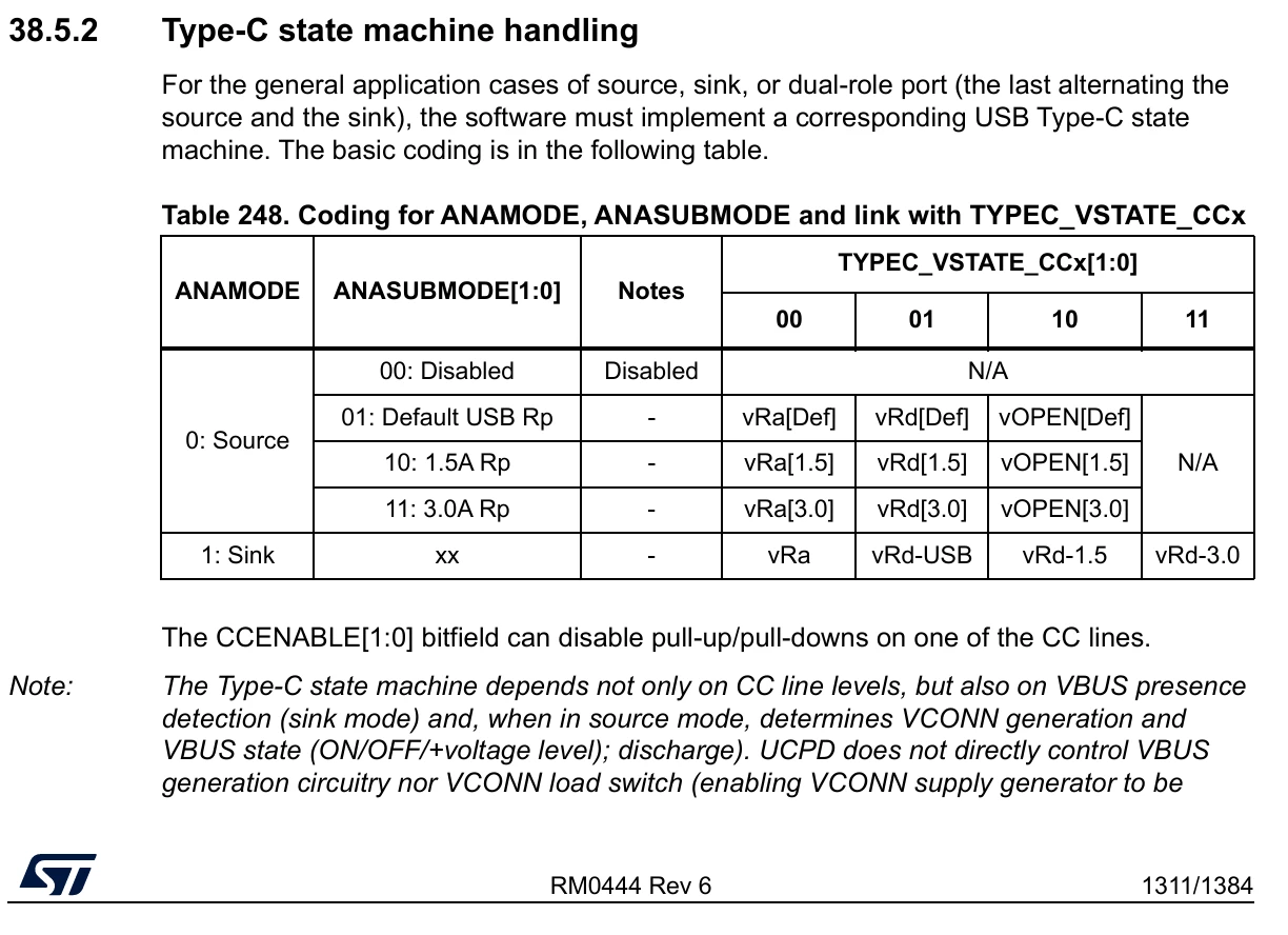

If the CC analog function is disabled via ANASUBMODE being disabled, the remaining observation of the line can only be done through an external sensing method such as ADC based polling. This is a workaround, not a supported silent Type-C / EMarker operating mode.

FBLBest answer
Apr 30, 2026 15:20 UTC
Hi @JamesC
The USB PD specification states that cable plugs must meet the receiver requirements for both a Source and a Sink during any transmission using the BMC signaling scheme.
Based on this requirement, we should raise a warning flag: with the current STM32 UCPD behavior, we cannot confidently confirm that the device will satisfy both receiver conditions at the same time for a cable application. Therefore, using this setup as a production cable design carries a risk of non-compliance.
Regarding the USB-PD sniffer example on STM32G071B-DISCO, this example appears to be intended for debug / monitoring purposes and may not be electrically compliant for a cable or eMarker design.
Summary of what the example is doing:
  1. Configure the analog path
    • Set ANAMODE = 0
    • Set ASASUBMODE = 0x00 (disabled)
2- Based on demo provided
