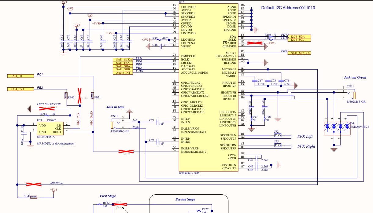

Hi Community,
I am working on STM32H747I-DISCO Board and trying to bringup digital MEMS Mic (MP34DT05) which is integrated on STM32H7-DISCO Board.
I am trying to record random voice for 5 seconds and need to play back via audio jack out which is connected to codec also it is integrated on the board. I am sharing you schematic of the board as below:
MP34DT05 is connected to MCU directly with SAI4 Interface and Solder Brifdges are provided to connect via codec
Here I developed the application code to interface and record via MIC and playback via Audio Jack out.

When I run this code i am facing issue at BSP_AUDIO_IN_PDMToPCM_Init();
Code is stuck at that function and not moving forward.
I need your suggestion/modifications of the code to work properly and what changes i need to do for BSP_AUDIO_IN_PDMToPCM_Init() function to work correctly
Note : I added required driver files(discovery files) for codec config and mic config.

1.MIC is shared by SAI4(MCU) and SAI1(codec). So to get PDM data which Interface I need to prefer?
 2.How to do this PDM to PCM convertion?

mƎALLEm
Apr 22, 2026 12:12 UTC
You need to debug that and find where it stucks. Maybe your application falls into Error_Handler() / while(1) or you go into a Hard fault!
Apr 28, 2026 05:33 UTC
Can you provide any reference example to read the PDM data via this MIC using appropriate interface.
Since I am trying to get data via SAI4 interface but unable to get it.
And one more issue is when I enable DMA and global Interrupt the callbacks are failing during debugging.
Provide me any example code to interface on this board and what ioc configuration is required for reading the PDM data.
The only example I can suggest is the one provided in CubeH7: https://github.com/STMicroelectronics/STM32CubeH7/blob/master/Projects/STM32H743I-EVAL/Examples/DFSDM/DFSDM_AudioRecord
