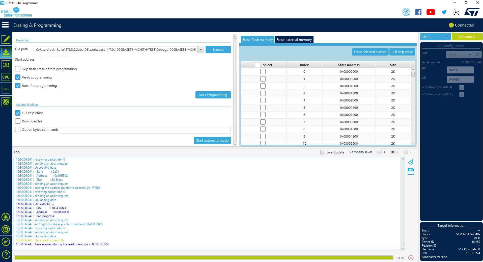

If I use the DFU programming over USB with STM32CubeProgrammer, the error occurred and the device doesn't start properly, but if I download the same program with ST-LINK everything runs ok. The MCU is STM32 G473.
I can connect the MCU over the USB, and read memory. Also, the data download and the data verification are ok. The programming procedure fails after the RUNNING PROGRAM... an error occurred after sending a dfu end of download request.
After that, the device doesn't work properly and it is stuck, but if I reset it starts working normally except for the EEPROM emulation that fails to write to FLASH memory. I attached the log from CubeProgrammer.

My colleague find the solution to the first problem, why the program doesn't start after flashing by DFU. If the #define USER_VECT_TAB_ADDRESS is uncomment in the system_stm32g4xx.c file, the vector table address is set to 0x08000000UL. After that program runs fine.
The error occurred after sending a dfu end of download request. is not the problem because this text is shown also when others MCUs are flashed with DFU and work fine.
The only problem that persists is EEPROM write fail after programming MCU by DFU.

We tried different methods of loading the binary from STM32CubeProgrammer. We used either System Bootloader (using USB) or directly via ST-Link.
Here are our results when the EEPROM emulation works and when there is error:
- When loading .bin file from USB bootloader or via ST-Link, EEPROM emulation does not work
- When loading .hex file from ST-Link, it works correctly
- When loading .hex file via USB bootloader, it does not work. However, after device reset, it starts working correctly.
- When loading .elf via ST-Link, it works
- When loading .elf via USB bootloader to an empty device, it does not work. However, when loaded to a device that is already loaded, it works correctly
To sum it up, using USB bootloader, only option working correctly is loading .elf to an already loaded device; .bin works after reset. Using ST-Link, everything except .bin works correctly.

Another update:
If we remove the ROM section (EEPROM emulation section) from the memory definition in the .ld file.
The previous definition was:
MEMORY
 RAM (xrw) : ORIGIN = 0x20000000, LENGTH = 128K
 FLASH (rx) : ORIGIN = 0x8000000, LENGTH = 128K - 8K - 16
 VERSION (r) : ORIGIN = 0x0801dfe0, LENGTH = 16 /* Reserved section for firmware version */
 ROM (rx) : ORIGIN = 0x0801e000, LENGTH = 8K /* Reserved for eeprom emulation */
The .bin file work after loading via ST-LINK instantaneously.
The .hex, .bin and .elf works if they are uploaded from the USB bootloader after the first reset.
