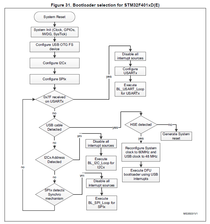

I have tried accessing the DFU using USART1 and it seems to connect OK. According to the AN2606, it would seem that the HSE is not detected:
However, the HSE probably works just fine when running in normal mode as USB CDC works and I am able to communicate using a terminal with USB COM port.

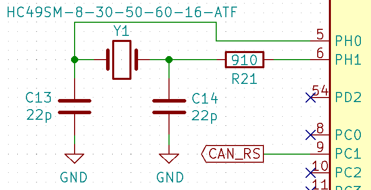

I use 8 MHz HSE:

How fast does the 8MHz oscillator start in your application? Could R21 have impact on this startup time?
Could you use, just as an experiment, an external oscillator?
The bootloader determines the crystal frequency against HSI - measure how precise HSI is.
Can't the bootloader falsely start using other interface, due to activity on some of the pins observed by the bootloader?

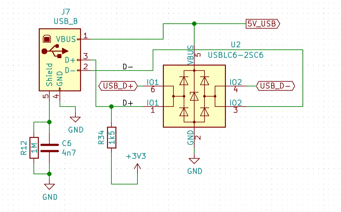

How exactly is the USB connector connected, what could it impact? What happens if you connect a USB charger instead of PC?

I tried shorting R21 but it seemed to have no effect. The connection of USB is following:

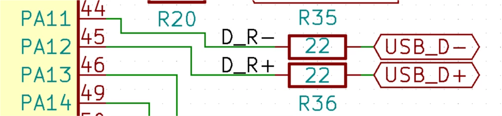

I already tried shorting the 22 Ohm resistors and removing the 1k5 pullup, but no visible effect.
When I connect the device first to power jack, then the usb charger, it seems to stay in bootloader (normal code does not start). Interestingly, when I reconnect the USB cable to PC, it is not recognized in Windows (almost immediately a error pops up).

The 1K5 resistor is not necessary as the MCU has the necessary built-in resistors. It is possible this is causing the issues.
