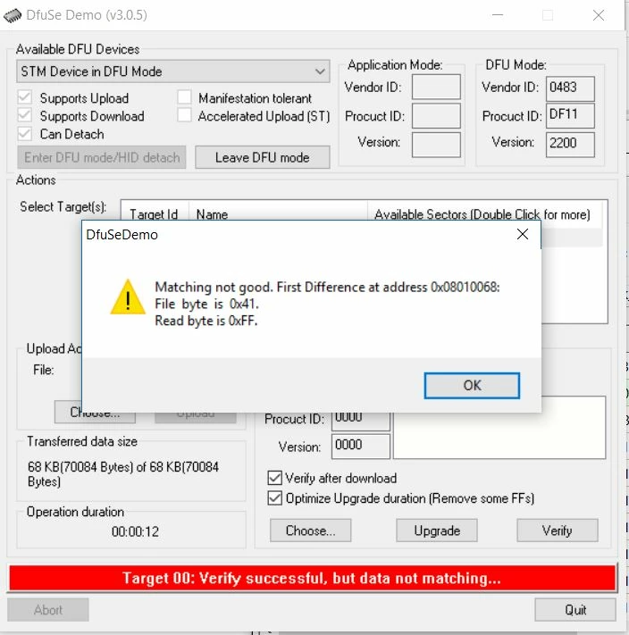

I'm using STM32L476RE in a custom board without HSE. I ported Discovery (76VG) Blink Project (following Clive1's DFU system bootloader) and successfully tested on my board in both Keil and TureStudio. It’s only a 4KB .DFU file to load by DfuseDemo. Now, in my real Truestudio project generated by CubeMx, the .dfu file is 68KB and DFU showing following error ''Matching is not good'' (attached).

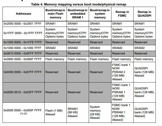

Am I doing something wrong in configuration? I can’t use Keil here as code size exceeds limit. Datasheet says, System memory 28KB aliased on 0x00000000-0x000FFFF and SRAM1 96KB and Flash 1MB (Attached Image). I request your guidance to solve this issue. In the final version of my custom board, I'll only have USB (or SD) to load program.

The other 64K+ seemed to go Ok.
One reported anomaly is that the System Loader expects 8-byte aligned/sized writes. The .HEX might have voids where this doesn't happen.
The tool I wrote should handle that, if not we can dig a bit deeper into your specific issue here.

Thank you, It worked immediately.. Good to have whole thing in a post.
It took quite a long for me to edit True Studio project to fit your bootloader. I guess L476 users will be benefited from it.

It represents code/concepts I had presented. The general solution would be to set the boot rom base to be zero, but I think the L4x6 devices all have it situated at 0x1FFF0000
