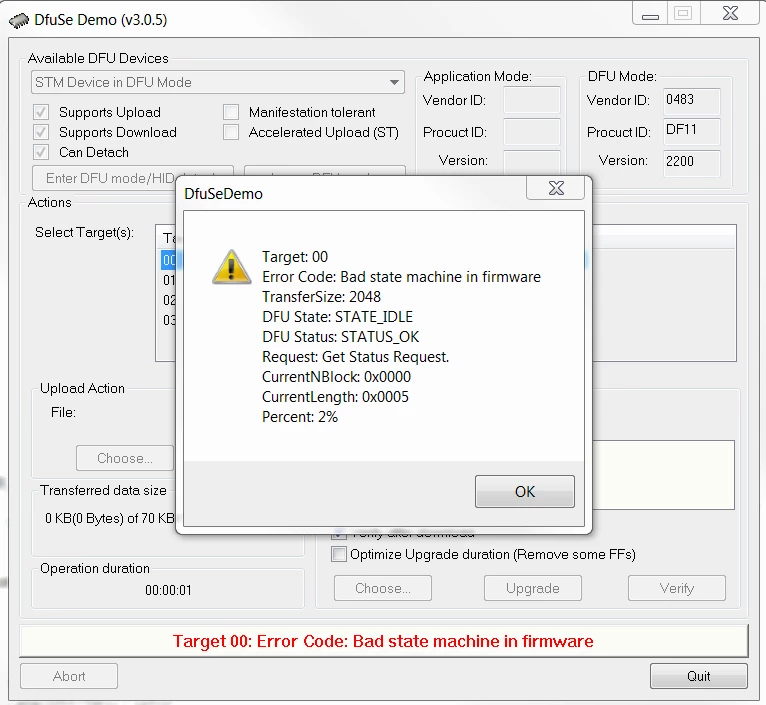

Hello Everyone,
I am have a problem using Dfuse (v3.0.5) with my STM32L432KC.
I have a USB CDC class, not using a composite CDC-DFU.
Performing the DFU mode through the boot pin/bit.
During upgrade I got the following error:
After several times (may differ), I can do the upgrade.
Has someone already solved this problem or have any advise?
#dfu #bad-state-machine

Posted on May 18, 2018 at 14:29
Does STM32L432KC have external clock source?
Check internal frequency via MCO pin PA8

Posted on May 18, 2018 at 14:37
I am not using an externel clock.
HSI48 for USB
HSI:16 -> PLL to get 80MHz for the rest

Posted on June 22, 2018 at 09:17
I add a sleep time of 50ms 'sleep(50)' in case STATE_DFU_DOWNLOAD_BUSY in RunThread() function inside the downloadthread.cpp file
I have compiled the DFUSE v3.0.5 using the source giving by ST with visual Studio 2017.
Now it's working.
