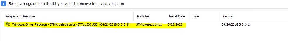

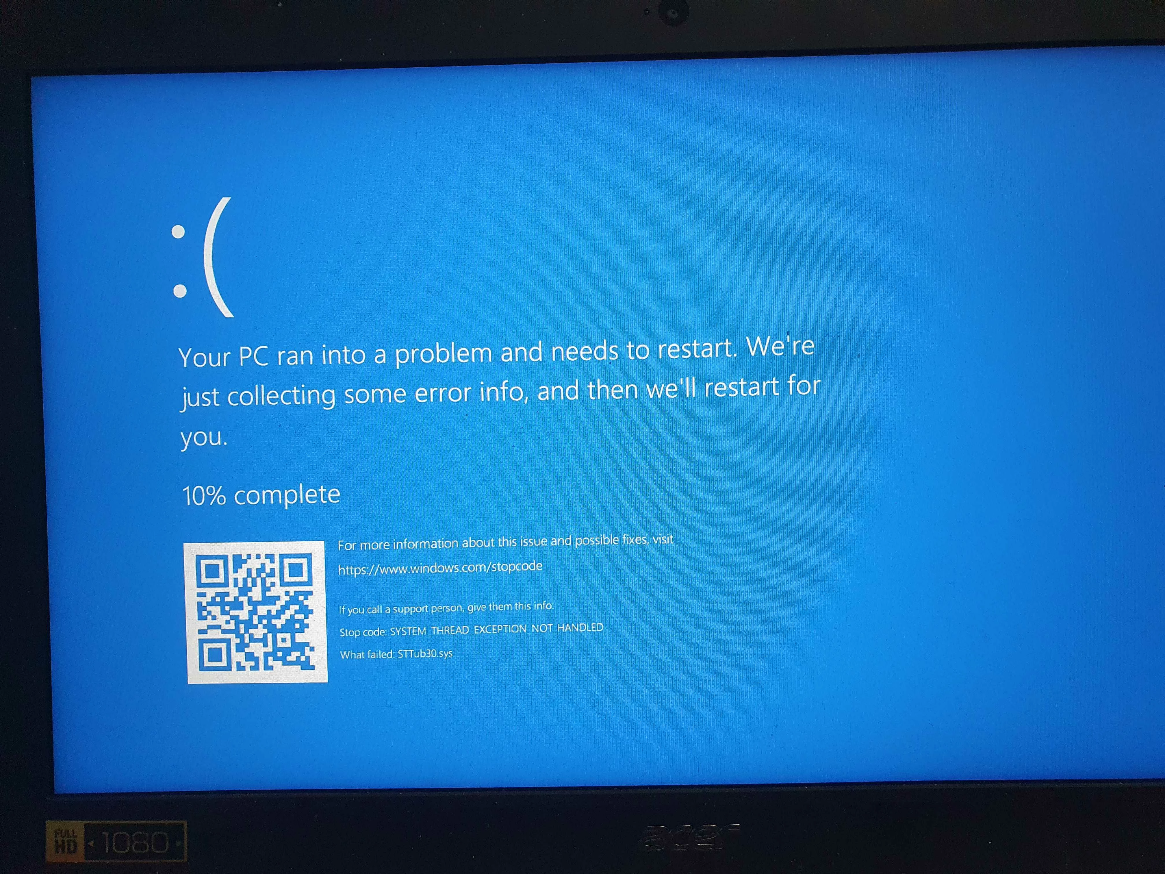

I'm using STM32L072KZT6 microcontroller, and I'm trying to make USB DFU Standalone bootloader. I've done many bootloader standalone firmwares for STM32 MCUs, for F0, F1, F3, F4 series, and had never encountered this kind of a problem. It's not deterministic, I've succeeded couple of times to write my firmware via DfuSe, and successfully run the main program, but in most cases it fails. Windows does not complain about the driver when the USB is plugged in, when I try to update it, it says that I'm already using the newest version.
The problem appears in the following moments:
  • When USB is plugged in
  • When Upgrade button is pressed inside DfuSe demo
I've tried different solutions, running DfuSe from STM32L folder, but nothing helped. My firmware is almost the same as an example for 32L0538DISCOVERY inside Cube L0 repository, and I'm using the latest version of L0 Cube firmware (V1.11.2). I've attached some pictures of the error message, driver version, and .zip file of my CubeIDE project.

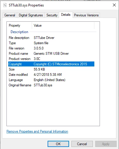

What is the version (properties-> details) and size of your \windows\system32\drivers\STTub30.sys ?
-- pa

0693W000001pUoRQAU.pngHi @Pavel A.​  thanks for your quick answer, the details of my STTub30 are in the attached picture. I've installed the driver from C:\Program Files (x86)\STMicroelectronics\Software\DfuSe v3.0.6\Bin\Driver\Win10

I'm facing the same problem here with DFU3.0.6 but with an older driver version (not sure from where I got this specific driver version :\ )
  • STTube Driver:
    • Version 3.0.1.0
    • Product version: 3.0B
    • Date modified: 20/07/2012
  • STM32 DFU driver:
    • Version 3.0.4.0
It worked a couple of times and then just starts generating BSOD

@Community member​ You can install the latest driver version from path I've posted above (C:\Program Files (x86)\STMicroelectronics\Software\DfuSe v3.0.6\Bin\Driver\Win10) but you need to install DfuSe v3.0.6 from ST official web site.

For me the stopcode was : SYSTEM_SERVICE_EXCEPTION (also STTub30.sys)
(and I took my screenshot at 40% :squinting_face_with_tongue: )
EDIT: seems I have an older SSTube driver btw, mine is File version 3.0.1.0, Product version 3.0B, Date: 2012-17-20 22:32
