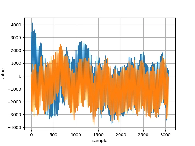

I am working on application that would use microphone array. Together with STM32H735IG board I decided to use STEVAL-MIC001V1 microphone array connected via DFSDM interface. I based my project on example available in CubeMX - DFSDM_AudioRecord project where same interface and microphones are used as an demonstration. While I use this project I don't have any problem, I am receiving echoed audio on headphones.
My problem begin here. While I copy most of this sample solution, my audio input that I read in the buffer on debug mode is totally out of expected results. I receive buffer full of 0x7fff and 0x8000 (after shifting, saturating and casting variable - see in the code).
My initialization code:

So program logic works without a flaw, interrupts fire correctly, data goes through some processing and everything repeats forever, but the data, as I mentioned on beginning, is just 0x8000 and 0x7fff (~32767) with occasional different values.
My DFSDM configuration should results in 8 kHz sampling frequency (using audio clock with 12 MHz, divided by 4 (results with 3 MHz) and 375 oversampling parameter):

What is interesting when oversampling is set to 68 (44,1 kHz sampling) values are much different, but still they are unexpected (most of them are based around ~64000 + few of them around 10-300).
PS. I checked clock signals with oscyloscope and they are correct - clocking with 3 MHz, data is changing on data pin.

after some work with this application and some support from ST employees I managed to get some pretty good outcome, as you can se on Picture 1. On output I can see sinusoidal wave that I am giving on input of microphones, but I get a lot of offset and noise as well.0693W00000DmmobQAB.pngChanges that was applied:
  • changed speed of clocks (12 MHz -> 4.8 MHz audio clock, divider 4 -> 3, Oversampling 375 -> 200)
  • switched up L/R signal on two microphones
  • changed casting to int16_t because old one was causing wrapping
AudioBuffer[i*2] = (int16_t)(SaturaLH((LeftRecBuff[i] >> 8), -32768, 32767)); // changed from (uint16_t)
