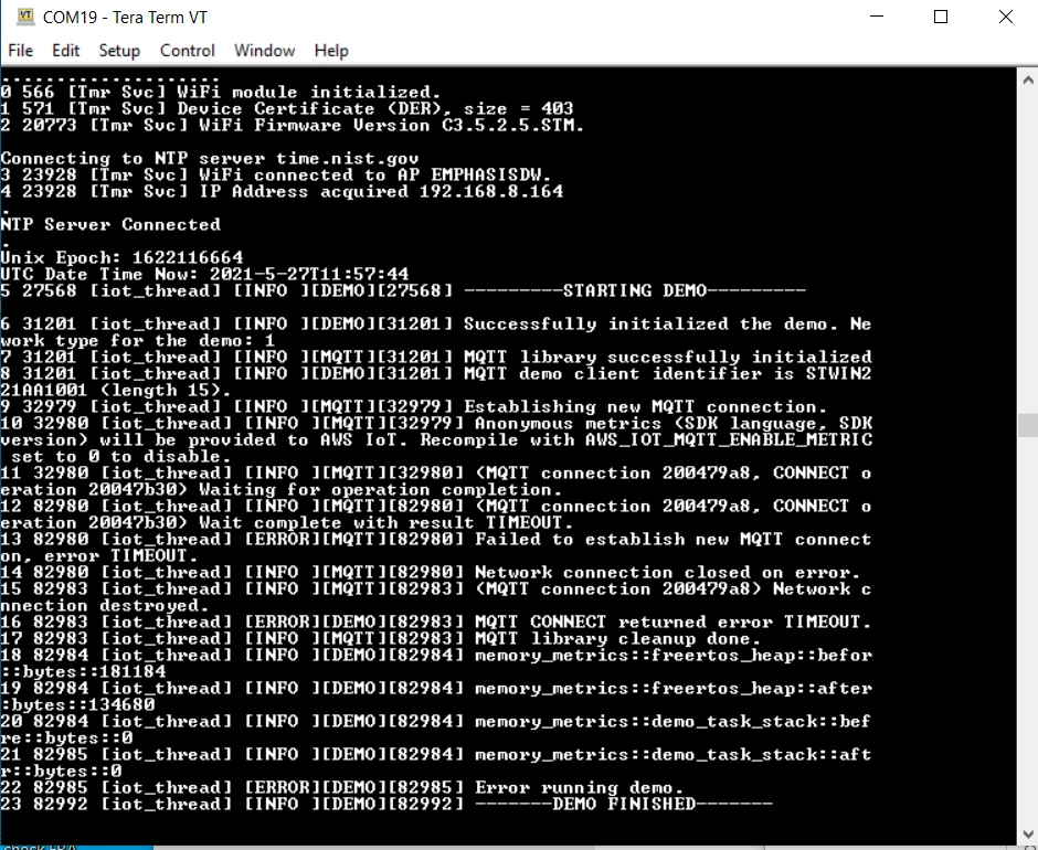

Device cant connect to AWS Cloud.
Hello to all,
I am using steval-stwinkt1b for a condition monitoring project. The fw that use is the default demo example of fp-cld-aws1 .
I have gone step by step according to UM2186. Although when I try to connect i receive this message
0693W00000AQ1S3QAL.pngAny suggestions?
Is some extra configuration necessary for the router?
