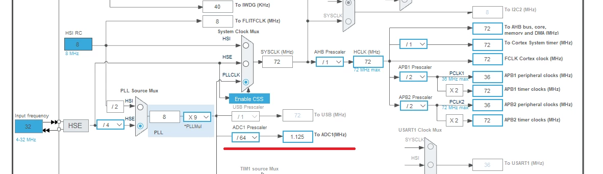

If ADC is using Asynchronous Clock Mode and prescaler is set to 64, then starting ADC right after calibration without delay fails. Other prescaler values work fine:

Does anyone have any idea why this program works like that?
