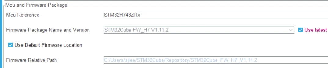

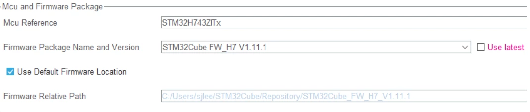

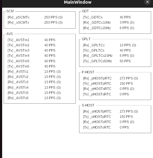

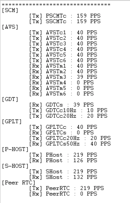

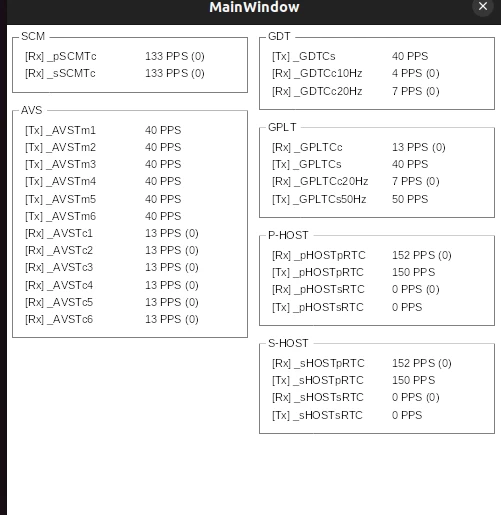

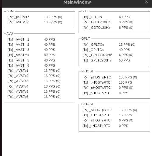

In STM32Cube FW_H7 version 1.11.1, UDP performance was normal, but in version 1.11.2, it fails to handle all transmitted and received packets. (STM32CubeMX Version 6.12.0)
Except for the STM32Cube H7 firmware version, all configurations and source code are identical.
- In STM32Cube FW_H7 version 1.11.1.
- In STM32Cube FW_H7 version 1.11.2.

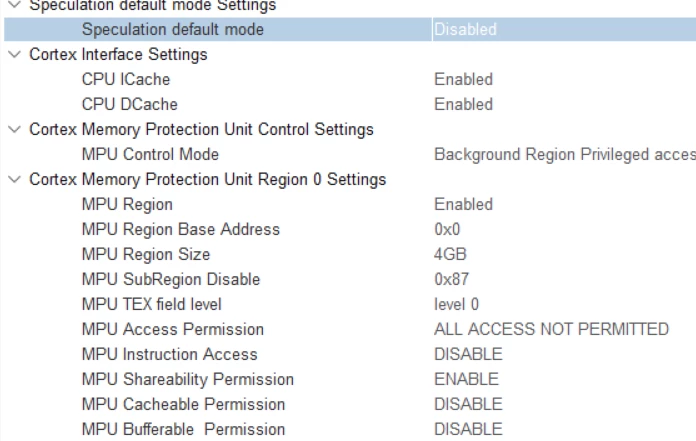

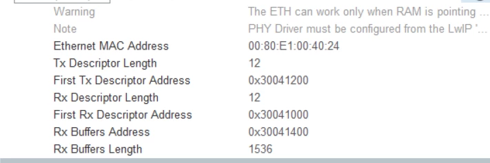

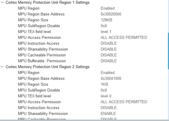

The configuration (without RTOS) of my project is below.
How do I fix this? Should I use version 1.11.1 temporarily? Or will this issue be fixed in the future?

could you please share the location of the descriptors.
Are you sure you have the same configuration in relation to the linker file for example?
if you can share the linker file and the generated Ethernetif.c file of the two project it will help us more in the investigation of this issue.

Aug 30, 2024 12:50 AM UTC
Hello @STea .

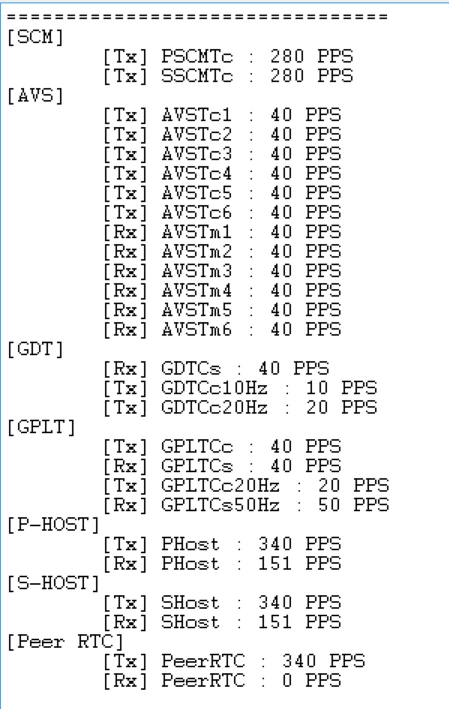

When you were testing, did you clean and rebuild the project?
In my case, I could see the same UDP performance when I simply built the code generated after changing the FW version from CubeMX. However, when I cleaned and rebuilt the project, I could see different performance.
I share the tested project and simulation program(PC side).
To use this simulation program, you have to change ip addresses by modifying DUAS_UdpTest.exe.config file of program and UDPComm.c file of the project.
I hope you can check this issue.
STeaBest answer
Sep 2, 2024 11:44 AM UTC
Hello @SungjunLee ,
I tried with both version of cube Firmware with you test but I get the same result as the second screenshot you shared booth firmwares are around 135 as an average .
I don't know exactly how this is calculated as i only have the executable but i would recommend you turning some known test version such as Iperf LWIP also make sure to check this fix related to the Ethernet driver and insure if it is applied on your firmware version.
update :
when changing the line 1212 of stm32h7xx_hal_eth.c as proposed by the github fixe i get better and stable performance :
 /* Set the tail pointer index */
 //tailidx = (descidx + 1U) % ETH_RX_DESC_CNT;
 tailidx = (ETH_RX_DESC_CNT + descidx - 1U) % ETH_RX_DESC_CNT;
