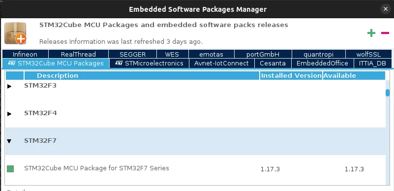

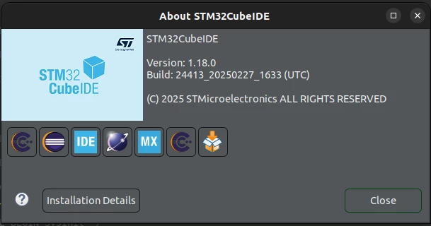

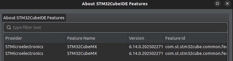

Here are the details of my stm32 cube environment.
Operating system: Ubuntu
STM32cubeIDE version details:
Firmware version : 1.17.3
