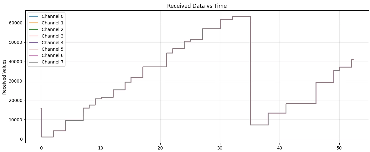

I have a 2-board communication project set up with 2 NUCLEO-H753ZI boards, where they communicate over UART. The sender side sends a 22-byte stream of data that is received by the receiver side and gets parsed into data. This data can then be streamed to a PC over Ethernet.
Inside of the UART_RxCpltCallback, I toggle the Red on-board LED, which gives me the rate at which packets are coming in. Inside the UART_TxCpltCallback I am calling a function that takes the data from the UART buffer, and moves it into a member variable of an object. All this should happen at 2KHz, but for some reason the data is only updating every few seconds, and it is not a specific rate at which it updates, it seems random. The graph might better illustrate what I am talking about. The graph *should* look like a sawtooth waveform.
The confusing part is that the LEDs work as expected, i.e. those blocks of code that are responsible for getting the data where it needs to be are surely executing, they just don't seem to do the thing I think they are doing.
AFAIK the receive buffer being used is in a non-cacheable region, so the issue should not be MPU or cache related.

I have some updates on this problem. It is not solved, but infact may be deeper that what I initially thought.
  • I have updated my code to allow packet-by-packet debugging so I can control when the packet is sent (no longer constantly streaming at 2KHz) and inspect the contents of the UART buffer immediately after.
  • The sending board is set up to send one packet at the press of the user button. It is not being debugged using the STLink in STM32CubeIDE
  • Each press toggles the RED LED on the sending board.
  • The receiving board is being debugged using the STLink in STM32CubeIDE. I am monitoring the firmware.serial_communication_.rx_buffer_ (this is the UART rx buffer) contents using the live expressions monitor.
  • Each time the HAL_UART_RxCpltCallback() is triggered, it toggles the RED LED on the receiving board.
  • Sometimes, even though the HAL_UART_RxCpltCallback() is triggered, verified using the RED LED on the board toggling, as well as scoping the UART line to see that the data was indeed sent, the firmware.serial_communication_.rx_buffer_ contents do not change. So far, I cannot explain this. This behaviour does not happen every time, and it does not occur in a regular or repeating fashion (e.g. if every Nth transmission is missed, something of that sort), it is truly random.
  • For this test, I have commented out the MPU_Config(), SCB_EnableICache() and SCB_EnableDCache() functions, so the MPU and cache should be completely disabled as per @MNapi 's comment.
  • I deprioritized all other interrupts apart from the UART Rx DMA interrupt, but this problem did not go away.
