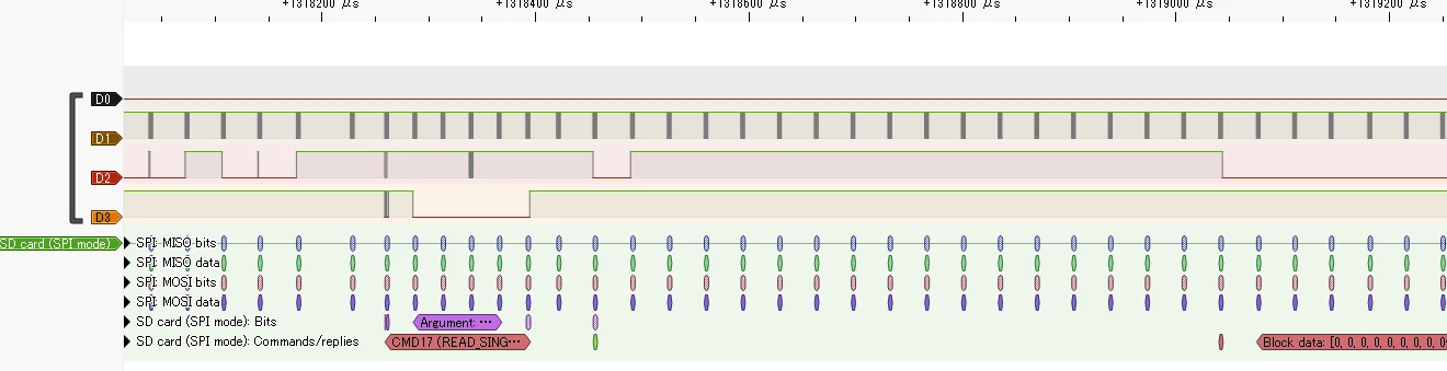

The analysis results from the logic analyzer are shown in the following image, and a response to CMD17 has been received.

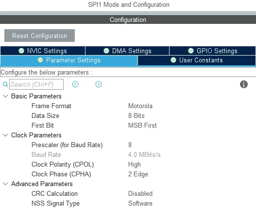

The strange thing is the SPI settings. The SD card specifications state that the SPI mode should be Mode 0, but in reality, communication fails on the first CMD0 if it's not Mode 3. Also, communication is not possible unless the SPI clock is set to 1MHz or higher (in this case, 32MHz (MCU) / 8 = 4MHz (SPI)).
The pin assignments and SPI settings are as shown in the diagram.

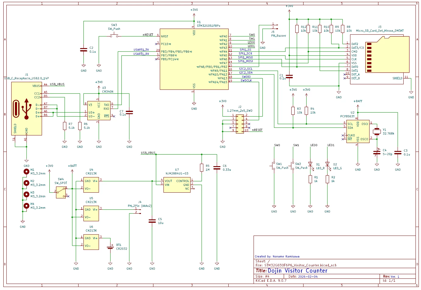

The circuit being debugged is as shown in the diagram, and all signal lines on the MicroSD card except SCK (including DAT2 and DAT3, which are not used in SPI mode) are pulled up with 10kΩ resistors.
