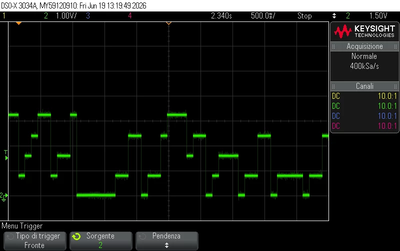

DAC out doesn't work properly on STM32H562ZI
Good morning everyone,
I need to drive an external pump using DAC out pheriperal.
I am working with an STM32H562ZI microcontroller and have followed the guide available at the following link: Getting started with DAC
Below is my current configuration:
* @brief DAC1 Initialization Function
* @param None
* @retval None
static void MX_DAC1_Init(void)
/* USER CODE BEGIN DAC1_Init 0 */
/* USER CODE END DAC1_Init 0 */
DAC_ChannelConfTypeDef sConfig = {0};
/* USER CODE BEGIN DAC1_Init 1 */
/* USER CODE END DAC1_Init 1 */
/** DAC Initialization
hdac1.Instance = DAC1;
if (HAL_DAC_Init(&hdac1) != HAL_OK)
Error_Handler();
/** DAC channel OUT1 config
sConfig.DAC_HighFrequency = DAC_HIGH_FREQUENCY_INTERFACE_MODE_ABOVE_80MHZ;
sConfig.DAC_DMADoubleDataMode = DISABLE;
sConfig.DAC_SignedFormat = DISABLE;
sConfig.DAC_SampleAndHold = DAC_SAMPLEANDHOLD_DISABLE;
sConfig.DAC_Trigger = DAC_TRIGGER_NONE;
sConfig.DAC_OutputBuffer = DAC_OUTPUTBUFFER_ENABLE;
sConfig.DAC_ConnectOnChipPeripheral = DAC_CHIPCONNECT_EXTERNAL;
sConfig.DAC_UserTrimming = DAC_TRIMMING_FACTORY;
if (HAL_DAC_ConfigChannel(&hdac1, &sConfig, DAC_CHANNEL_1) != HAL_OK)
Error_Handler();
/* USER CODE BEGIN DAC1_Init 2 */
/* USER CODE END DAC1_Init 2 */
After that, I implemented the following example and expected to obtain a stepped waveform. However, the result is not as expected: the DAC seems to skip some steps, producing an irregular curve as shown in the image below:

setRaw method performs other checks before doing HAL_DAC_SetValue. By performing the HAL_DAC_SetValue call directly doesn’t change.

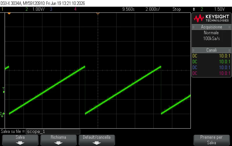

On the other hand, when I run the provided example code, the generated waveform is correct:
strange steps curve
using the example code insted seems the generated curve is correct:
example triangular curve
Could you please help me understand what I might be missing?
Thank you in advance,
Mattia

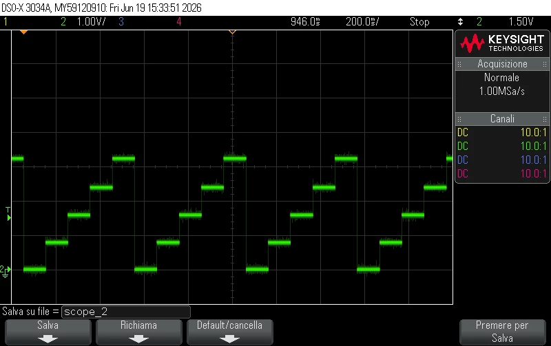

MattiaB
MattiaBBest answer
Jun 19, 2026 13:14 UTC
Connecting the DAC pheriperal to a TIMER trigger the DAC start to work properly:
sConfig.DAC_Trigger = DAC_TRIGGER_T1_TRGO;
6 replies
So look at how your code differs from the example code … ?
MattiaB
MattiaBAuthor
Jun 19, 2026 11:13 UTC
Changing only the main function it works.
The only difference is that I change every 100 ms the value and the values are not contigues each other (1000, 2000, ecc..).
The example perform a step of one unit (0,1,2, ecc...) every millisecond.
HAL_DAC_SetValue(&hdac1, DAC_CHANNEL_2, DAC_ALIGN_12B_R, dac_value);
if (dac_value < 4095) {
dac_value++;
} else {
dac_value=0;
HAL_Delay(1);
So why my solution cannot work?
Andrew Neil
Jun 19, 2026 11:21 UTC
No, that’s not the only difference!
You do all this:
    while(HAL_DAC_STATE_READY != HAL_DAC_GetState(&hdac1));
while((hdac1.Instance->SR & DAC_SR_DAC1RDY) == 0x00);
do {
HAL_DAC_SetValue( &hdac1, DAC_CHANNEL_1, DAC_ALIGN_12B_R, value_raw );
} while(HAL_DAC_GetValue(&hdac1, DAC_CHANNEL_1) != value_raw);
The example simply does HAL_DAC_SetValue
BTW: what’s the point of the return value from setRaw - it’s always true !?
