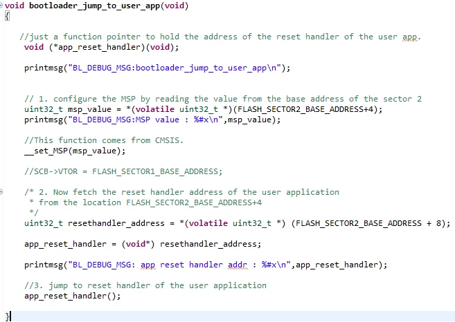

I already have developed a custom uart bootloader program on STMcube IDE for STM32f446 (Nucleo board) and an host C# app to fully functionality of bootloader services and i functional well.

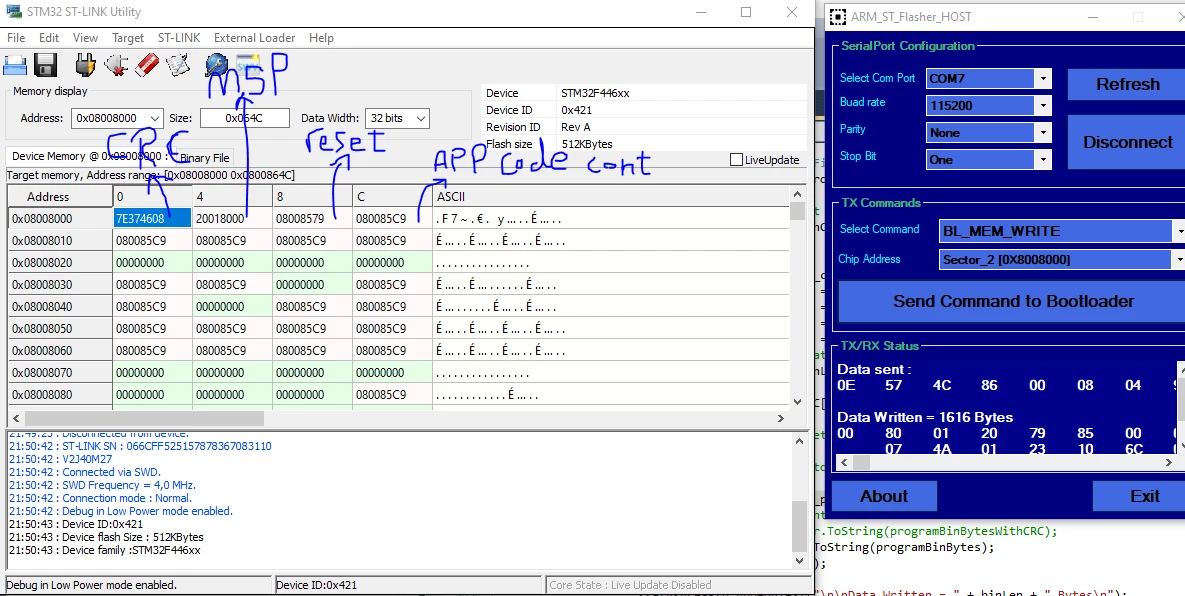

The problem is that i need to add feature which make sure or verify the integrity of the user app code before run it (i.e. after it receive Go_to_User_App command from C# app/tool). the implementation i made is that is to append the 32-bits CRC code of the user app at the begining of the .bin file. so, the 1st word of app is now CRC code of app. and 2nd word is the MSP. and 3rd word is the REST handler. after doing that the user app is not running as expected!
so, need more help for identify the issue up there please.
below is screenshots illustrations.
*this is the memory layout after flashing the user app code with appending its CRC at the 1st word at sector 2 (address of 0x08008000)*
*this is the C function in bootloader code that perform the jump to user app without checking the CRC of app code yet*

Put the CRC at the end of your code, not at the beginning.
Or:
Read, save into a variable but do not program into Flash the CRC value, then program the 2nd word of data to the first Flash location, then, after programming the whole content, check the CRC.

You may put the CRC at 0x08008020 - it's not used by F4.

It's quite generic. Look at ARMv8-M architecture definition and find the unused exception vector in the vector table (first 16 words of memory), then use it for CRC. The exception vector table must start at aligned address, like multiple of 256 - you can't locate it at address 4.

Is this part of the vector table or in front of it?
How do you compute the CRC on the PC side?
Do you need to know the length of the image?
I would tend to put the length in an unused vector, and put the CRC at the end, and then repeat the computation as it was done on the PC side to verify they are correct.
