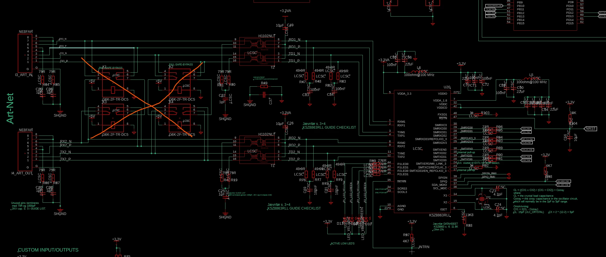

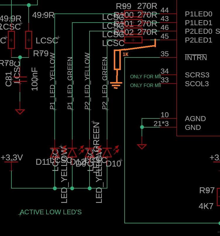

I have made a custom PCB based on STM32H723VGT MCU and KSZ8863RLL with interface RMII. I have followed the Hardware Design Guide for the KSZ8863. Including 100 Ohm impedance from RJ45 to PHY and 50 Ohm impedance from PHY to STM32. Length matching is also done with meanders.
Without any configuration from CubeMx I am expecting some activity on the LEDS when I plug a ethernet cable in the RJ45 connector.
Are there anyone with experience with the KSZ8863 3-port switch, that have any suggestions? I have added a picture of the schematic. The crossed is not implemented on the board, so please ignore those.

By comparing the development board schematic I found it very similar with my own. There are a lot of jumpers on the board to configure, for instance auto-negotiation etc... Not sure what settings is actually important for my application though....
I measure 25MHz on the crystal and 50Mhz on the RMII interface from the PHY. No activity on the differential signals and no led activity either side og the RJ45 cable...

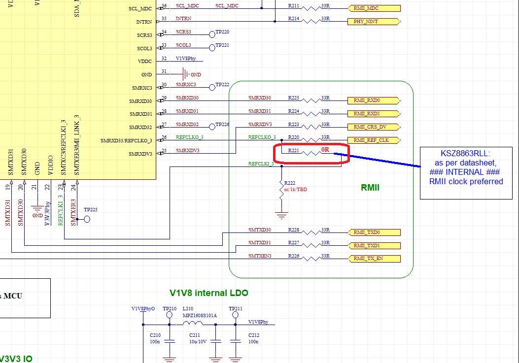

Jun 18, 2024 1:55 PM UTC
Finally found the problem on my board, maybe it's at least related to yours @DavidWahlberg
I wanted to set it up without I2C or SPI, which means no access to all registers, especially register 198d, which needs bit 3 to be set (default = 0) to use its own RMII reference clock internally.
So maybe your problem is that you have not set that bit, as it looks that you want to use the clock internally.
So I set the strap options so that I can use the clock externally extra routing via R221, which was originally 33 Ohms, as the other RMII resistors.
But even that value is too big, seemingly causes a tad too much phase shift or whatever, replacing the 33R with 0R solved the problem, now it's really running smoothly.
I will switch the interface to I2C, so that I can use the clock internally, because this small change sounds like it's timing-wise "on the edge".

I have thought of your suggestion of setting 3-bit in register 198, which would make sense. On my custom PCB I have routed the SMI interface, but as @Pavel A.  mentioned about the limited register access, I am trying getting the SPI interface up and running. For that reason I ordered the ksz8863 daughter board (https://www.microchip.com/en-us/development-tool/ac320004-7) to have access the pins as well as multiple strap options. I have wired it up and made the strap option for [P2LED1, P2LED0] = [1 , 0] to enable SPI slave mode. However, still no good response on the MISO line when trying to read 0x00 register (I am expecting a response of 0x88 according to datasheet).
How far have you come you your project? Can you confirm that my SPI transfer is correct?
Friendly regards, David

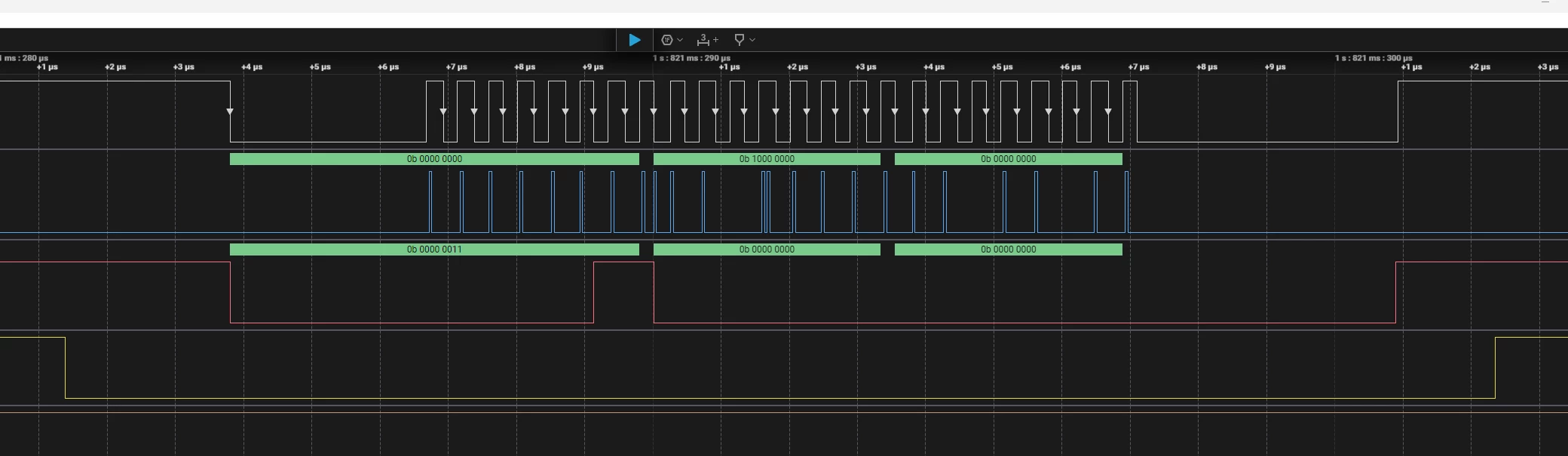

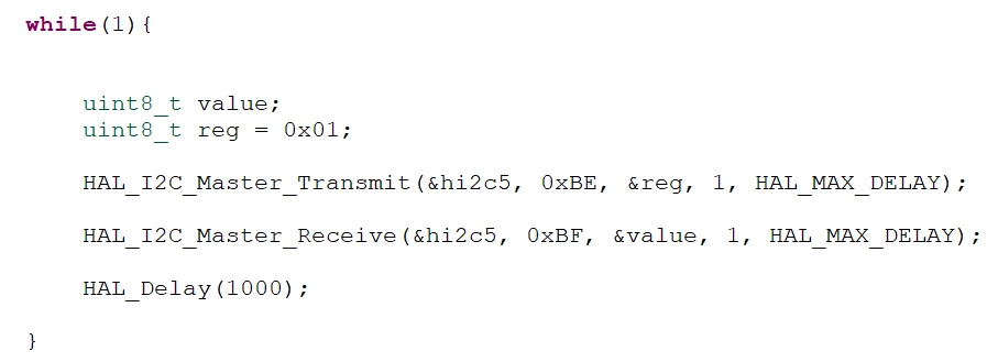

My simple code is above ^. Using the logic analyzer I can see this:
I never received any ACK from the ksz8863. I am trying to read register 0x01 to return 0x3, as stated in the datasheet.
Can you confirm that I am on the right track, @LCE ?

I have no idea about HAL I2C, I can only say that the I2C addresses are correct.
Have you strapped the interface selection pins correctly?
On the logic analyzer we see 0xBE and 0xBF sent out directly after each other, which does not make sense, unless you want to write register 0xBF.
But yeah, first try to get an ACK.

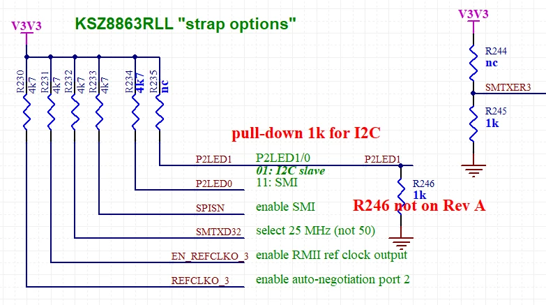

Sep 6, 2024 6:45 AM UTC
My original design did not have strap, so I have soldered a resistor on 1KOhm as shown in the picture. When pulling reset low, the LEDS on  P2LED1 and P1LED0 lights up and then turns off when releasing nRST pin. I can measure 1.8V on pin 32 and 42. I can measure 25MHz from the crystal and 50Mhz on pin 26. But sadly still cant get a ACK when writing to pin 37 and 36... :(
Can you confirm the straps for I2C-slave mode?

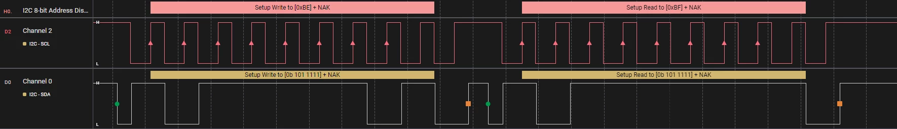

Sep 6, 2024 9:44 AM UTC
Don't have time now, check the DS and the pdf for the eval board.
You might need an extra pull-up an P2LED0.
Here's a screenshot of my working setup:
