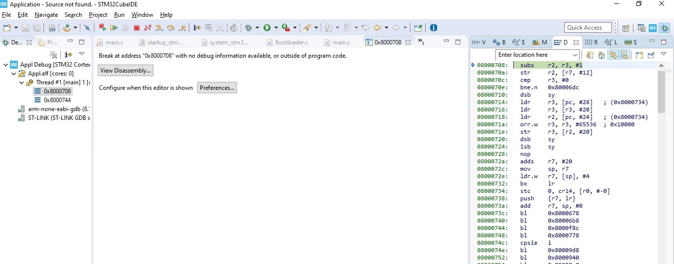

Custom Bootloader jump to application and vice-versa are failing
I am trying to develop a custom boot-loader on Nucleo-H743ZI2 evaluation board. But the boot-loader is not jumping to application code. I had referred to the other posts regarding the topic and adopted some code from those also. I had flashed the codes of application and boot-loader to the respective memory locations at 0x8020000 and 0x8000000.
Please do point me to the problem in the code provided.

Uwe Bonnes
Chief
Sep 8, 2020 8:48 AM UTC
Do the switch between user and bootlaoder as early after reset as possible. That works for me and many others.
Sridhar
SridharAuthorBest answer
Sep 8, 2020 11:24 AM UTC
Thank you, it had worked. I had changed the bootloader and application to maximum frequency.
