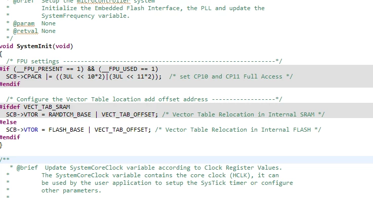

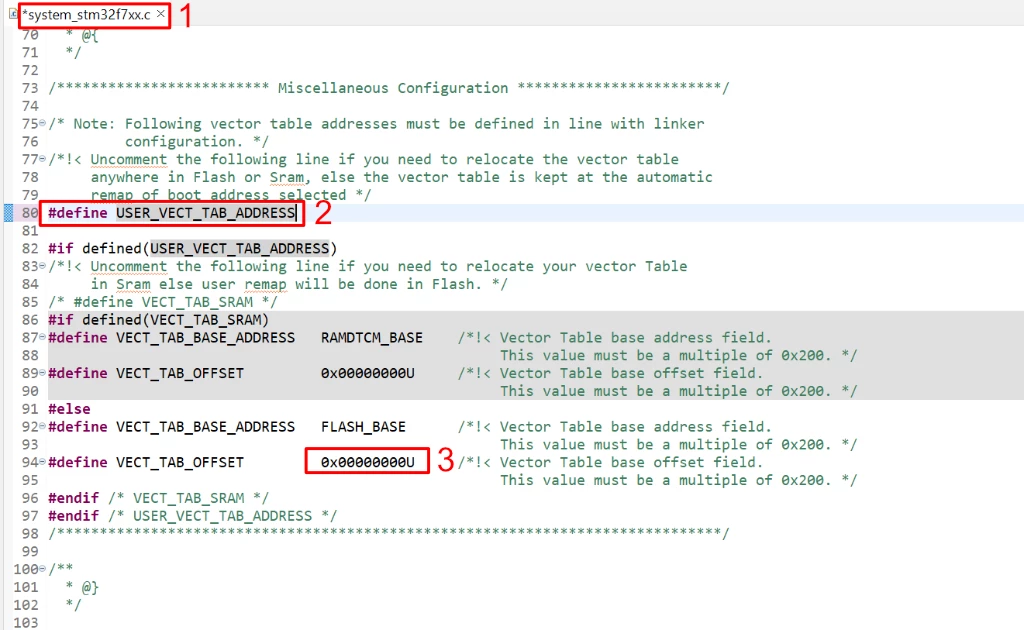

Karl Yamashita
Feb 26, 2025 7:23 AM UTC
  1. find system_stm32f7xx.c file
  2. Uncomment this define
  3. Change value to your application address
If a reply has proven helpful, click on Accept as Solution so that it'll show at top of the post.CAN Jammer an open source CAN bus hacking toolCANableV3 Open Source

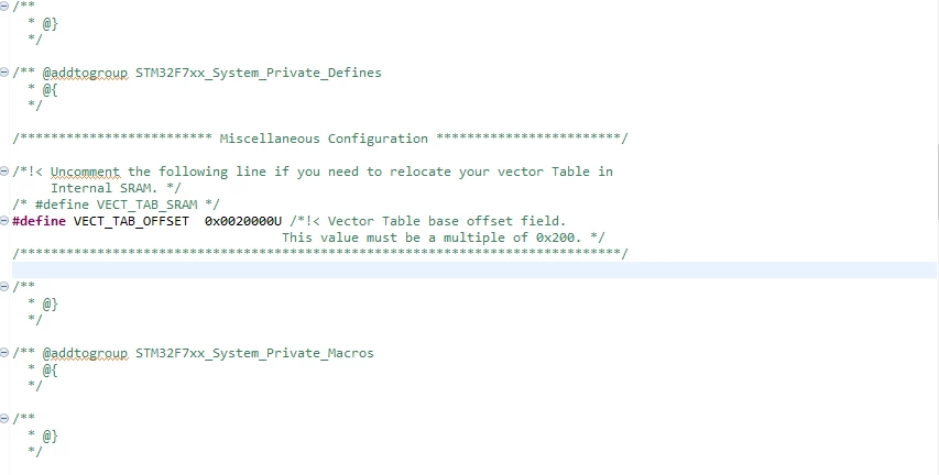

Feb 26, 2025 7:31 AM UTC
Thank you for your valuable reply, but the changes have already been made and tested.
