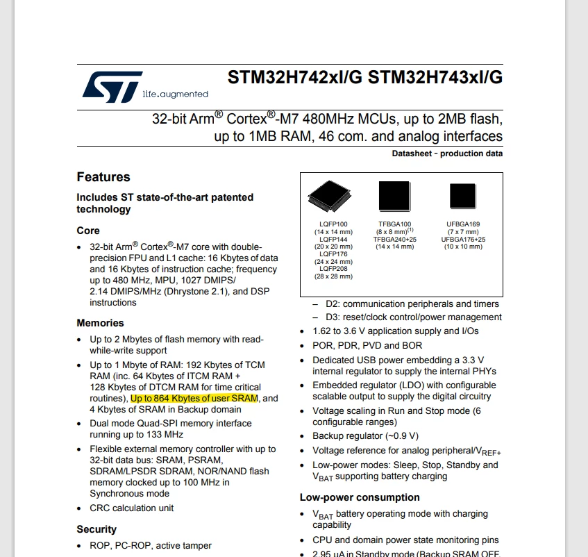

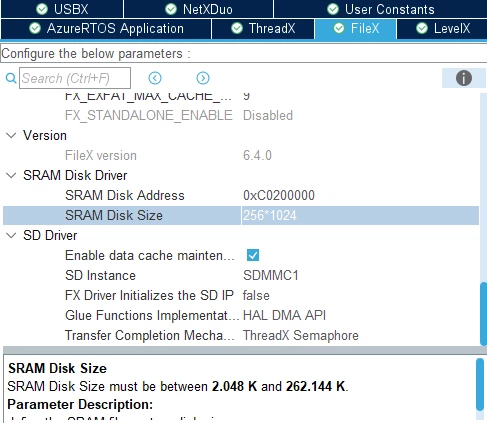

Why is there a limitation to the maximum Disk space in FileX?  256K is too small.  I would like to allocate 64Mbytes.

matt-crc
matt-crcAuthor
Senior III
Feb 20, 2025 12:05 PM UTC
Hi @Saket_Om
I did and the memory is available.  I highlighted the available memory on the datasheet

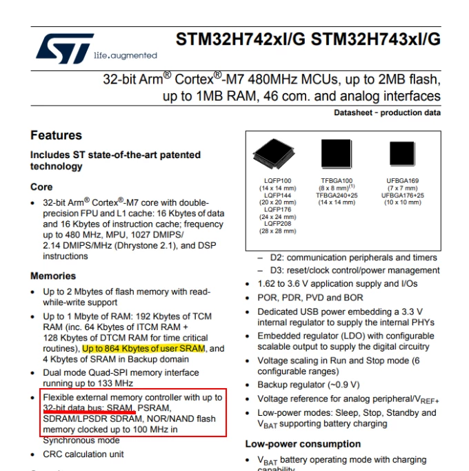

Feb 20, 2025 1:51 PM UTC
Hello @matt-crc
This is not an embedded SRAM. It concerns the FMC (Flexible external memory controller) peripheral which can control an external SRAM.
In order to give better visibility on the answered topics, please click on 'Best answer' on the reply which solved your issue or answered your question. Saket_Om
matt-crc
matt-crcAuthor
Senior III
Feb 20, 2025 5:20 PM UTC
hi @Saket_Om
ok, but i find it very strange that FileX can be configured to use the FMC with the external Flash (Nor/Nand) without that limitation, but it can't use the very same FMC for a RAM disk...
Tesla DeLorean
Guru
Feb 20, 2025 5:49 PM UTC
Yes, doesn't make sense to me either, should be able to use the SDRAM, and however large that is, less the offset into it.
Perhaps SRAM DISK is too specific, and there should be an SDRAM-DISK, or a more generalized RAM-DISK
@STTwo-32 please flag this for consideration/review for parts supporting external memory and/or SDRAM enabled, and an "Address" field in the user interface.
