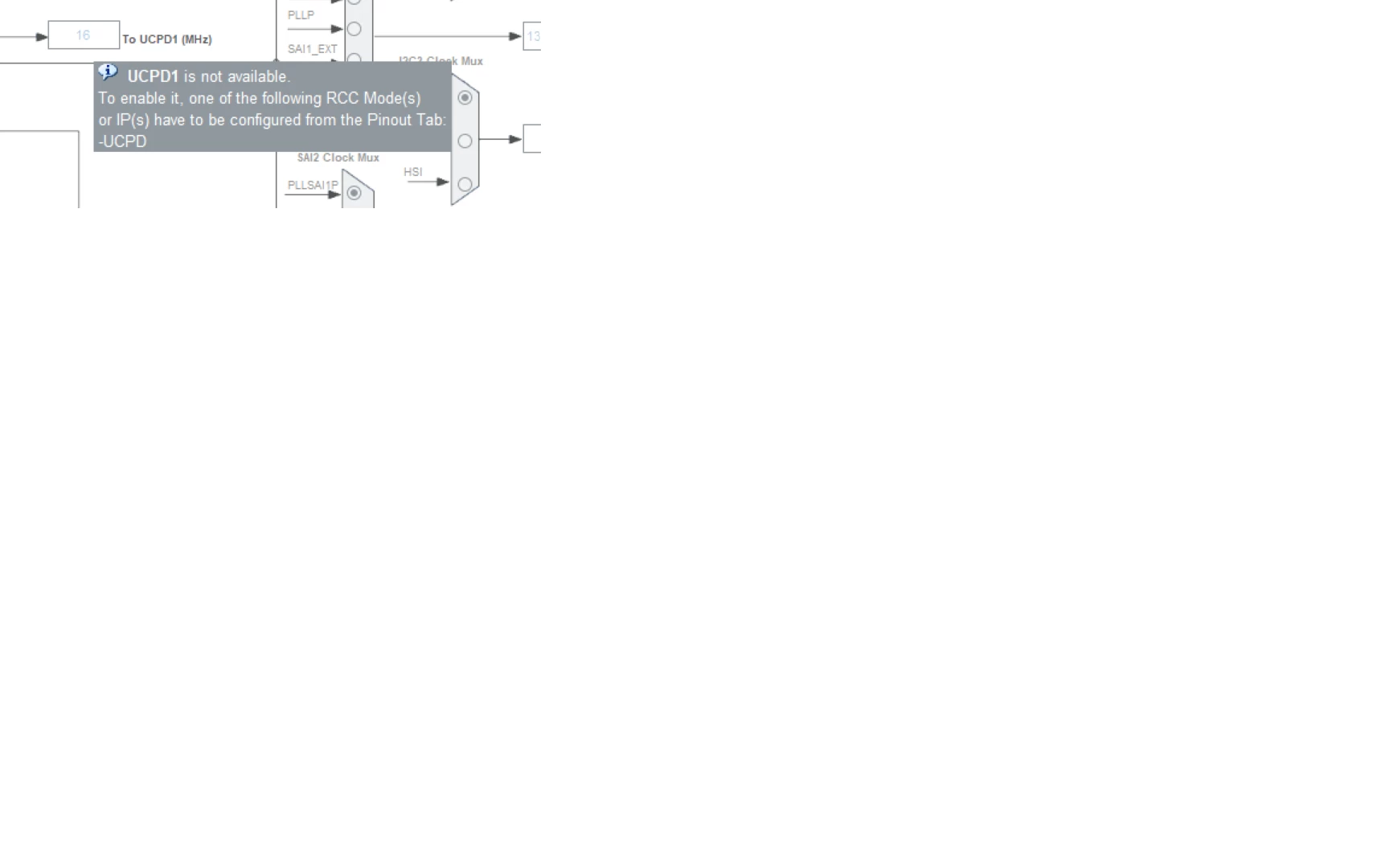

CubeMX fails to properly enable UCPD peripheral
When I enable UCPD1 in Sink mode on STM32L552 using CubeMX the clock generator tab still lists the IP as being disabled. How do I manage to get it enabled properly?

Hello @Bas van Loon​
Thank you for your contributions and for your detailed explanations,
I confirm the issue on my side, it has been reported to STM32CubeMX development team .
Internal ticket number: 154256(This is an internal tracking number and is not accessible or usable by customers).
I will keep you posted with updates.

Amel NASRI
Nov 30, 2023 8:53 AM UTC
Fixed with STM32CubeMX 6.10.0.
