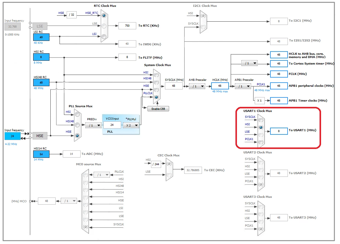

Hi!
For me, the new 1.8 version of CubeF0 is completely broken. Using the HAL RCC driver, it tries to
a) enable USART2 that I don't use, and it fails because it can't set its clock source
b) enables HSI oscillator (which I don't use) without setting the calibration value. If I use HSI for something, calibration value is set.
Using the LL RCC driver the above issues are not present, but the PWR module clock isn't enabled and I can't write the backup domain (LL_PWR_EnableBkUpAccess in SystemClock_Config has no effect because the registers don't have clock). Because of this, initializing the RTC fails with a timeout and my controller gets stuck in the error handler.
Now these issues are easily worked around but it was very frustrating to debug.
#ll-bug #stm32cube-bug #hal-bug

Hi
Buga.D_niel
I'm not able toreproduce this even with the ioc file you have attached. Is this the ioc file where the issue occurs?
For further debug, could you please send us the STM32CubeMX.log file (found under your user directory in the .stm32cubemx folder).
You're using the HSI as a clock source for the USART1 peripheral.This is the reason why HSI oscillator is enabled.

Cyril FENARD
September 28, 2017
Posted on September 28, 2017 at 13:51
Hi
Buga.D_niel
Thank you for posting the problem.
The correction is provided in the next CubeMx v4.0.
(RCC_OscInitStruct.HSIState is not set to RCC_HSI_ON if OscillatorType is other than the HSI case).
