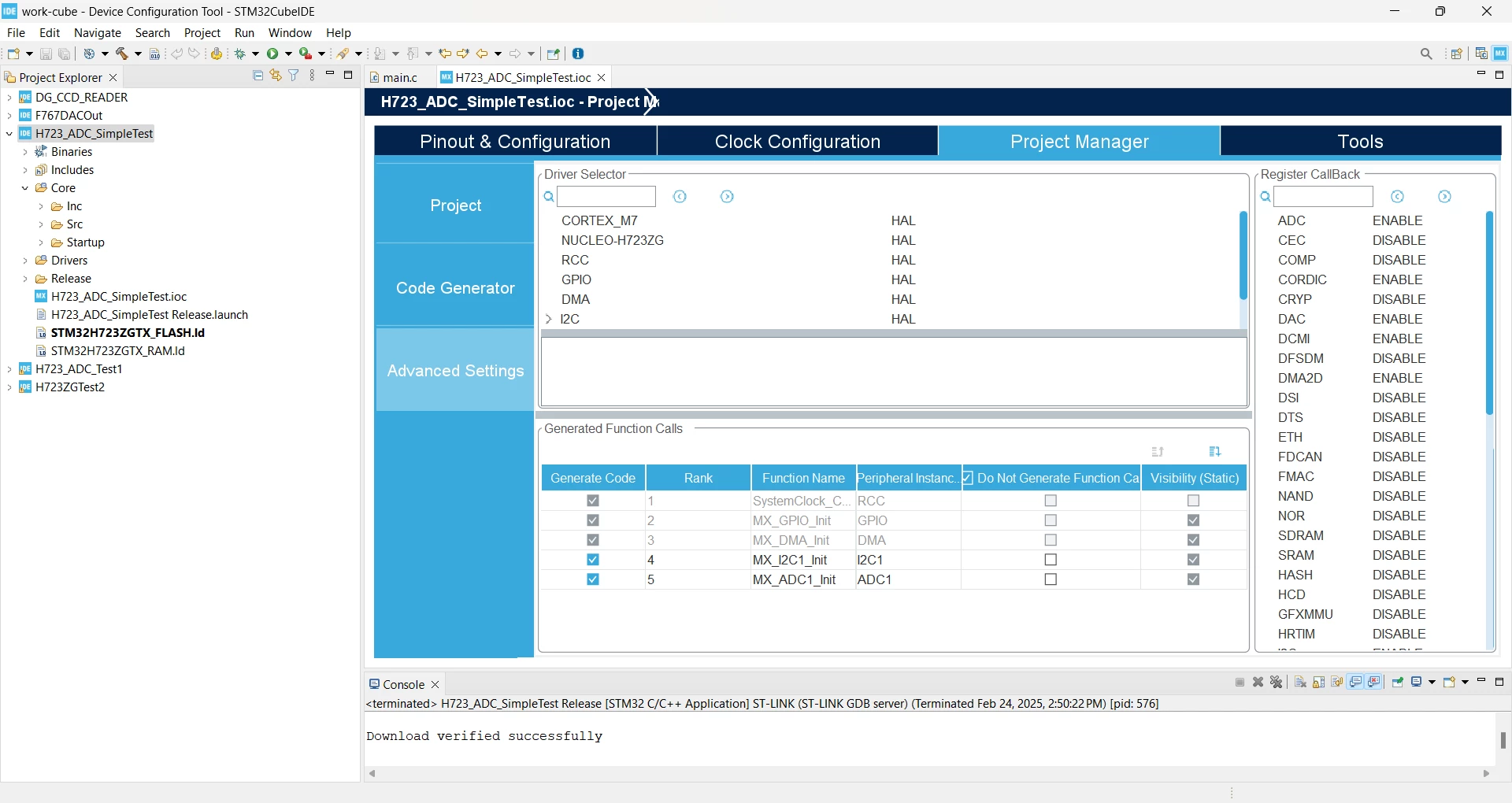

DG91Author
Feb 24, 2025 12:54 PM UTC
Dear @AScha.3
thank you for your reply, yes it is activated.
I am attaching a respective screenshot.
Any suggestions would be really helpful. Thank you
