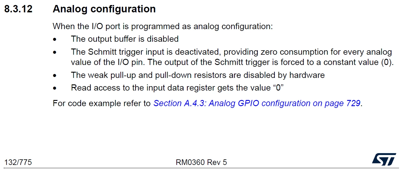

Why set the speed mode to High ?
The default is Low.
I guess it doesn’t actually make any difference, as the speed is irrelevant in Analogue mode?
So does it actually need to be explicitly set at all ?

Let me guess: the code was copypasted from somewhere where it did matter?
The digital output setting is irrelevant when the port is set to Analog, but the struct has to be filled in completely.
I thought so.
And that should also apply to the pull-up/down:
waclawek.jan
July 16, 2026
Yes.
