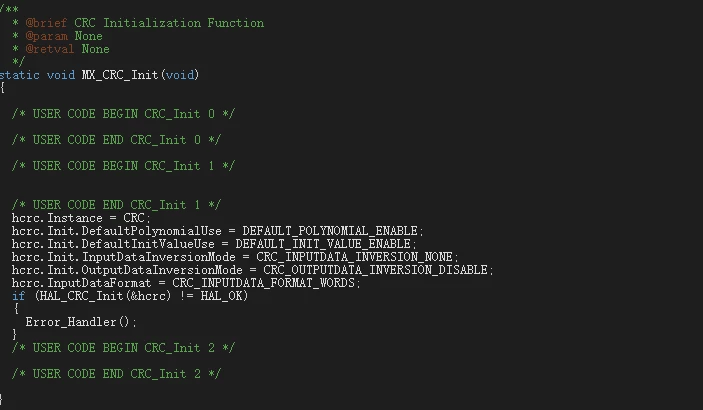

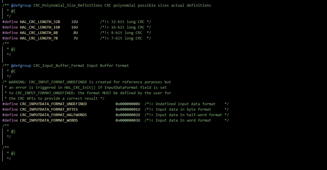

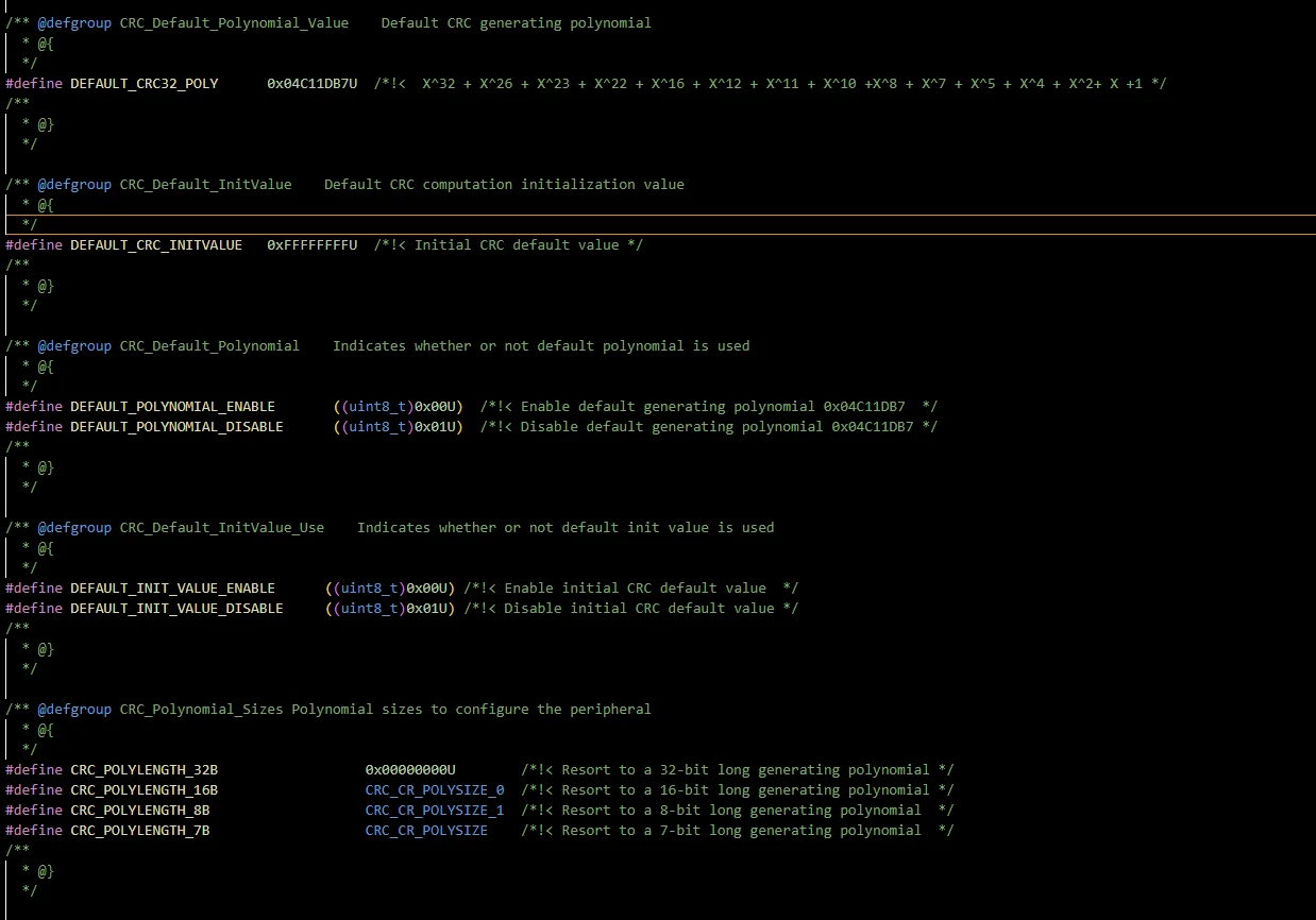

Hello @davidcodes
Could you please try with changing the default initial value?
 hcrc.Init.InitValue= 0x00000000;
 hcrc.Init.DefaultInitValueUse =DEFAULT_INIT_VALUE_DISABLE;
