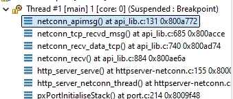

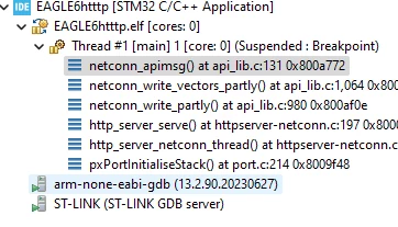

Looking at httpserver-netconn.c, I see that the netconn_write() never exits.
At the first call
 else if((strncmp(buf, "GET /STM32F4xx.html", 19) == 0)||(strncmp(buf, "GET / ", 6) == 0))
 /* Load STM32F4xx page */
 fs_open(&file, "/STM32F4xx.html");
 netconn_write(conn, (const unsigned char*)(file.data), (size_t)file.len, NETCONN_NOCOPY);
 fs_close(&file);
necconn_write() does not exits since it is blocked by the semphore in api_lib.c
static err_t
netconn_apimsg(tcpip_callback_fn fn, struct api_msg *apimsg)
 err_t err;
#ifdef LWIP_DEBUG
 /* catch functions that don't set err */
 apimsg->err = ERR_VAL;
#endif /* LWIP_DEBUG */
#if LWIP_NETCONN_SEM_PER_THREAD
 apimsg->op_completed_sem = LWIP_NETCONN_THREAD_SEM_GET();
#endif /* LWIP_NETCONN_SEM_PER_THREAD */
 err = tcpip_send_msg_wait_sem(fn, apimsg, LWIP_API_MSG_SEM(apimsg));
 if (err == ERR_OK) {
 return apimsg->err;
 return err;
 There are two calls to netconn_apimsg(). The first exits:
the second is blocked by
 tcpip_send_msg_wait_sem()
This is the problem but the mechanism according which these semaphores are managed is still obscure to me.

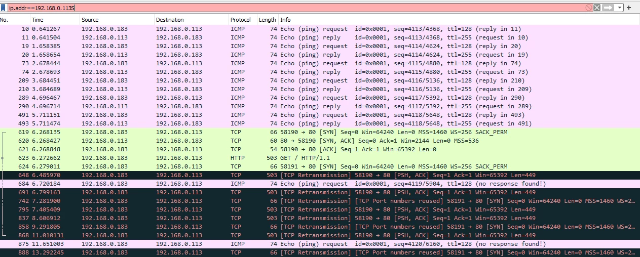

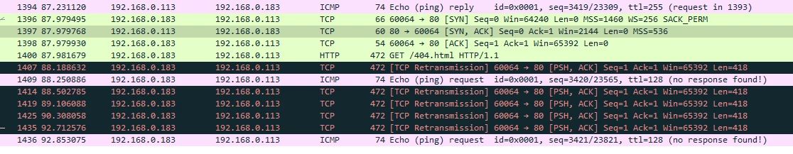

Sep 25, 2024 9:39 AM UTC
Looking at wireshark capture I get this kind of packets.
The LwIP blocks in netconn_write call for the semaphore issue as stated above.
fs_open(&file, "/404.html");
fs_close(&file);
Thank you.

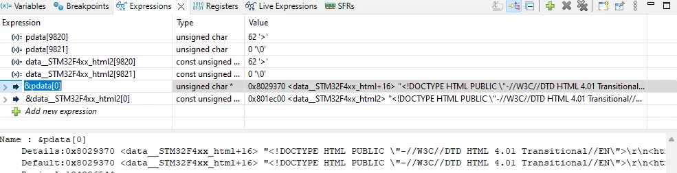

I have found the point which cause the issue.
When I include the page inside httpserver-netconn.c
static const unsigned char data__STM32F4xx_html2[] = {
/* /STM32F4xx.html (16 chars) */
//0x2f,0x53,0x54,0x4d,0x33,0x32,0x46,0x34,0x78,0x78,0x2e,0x68,0x74,0x6d,0x6c,0x00,
/* raw file data (9821 bytes) */
0x3c,0x21,0x44,0x4f,0x43,0x54,0x59,0x50,0x45,0x20,0x48,0x54,0x4d,0x4c,0x20,0x50,
0x55,0x42,0x4c,0x49,0x43,0x20,0x22,0x2d,0x2f,0x2f,0x57,0x33,0x43,0x2f,0x2f,0x44,
0x54,0x44,0x20,0x48,0x54,0x4d,0x4c,0x20,0x34,0x2e,0x30,0x31,0x20,0x54,0x72,0x61,
len = strlen((char*)data__STM32F4xx_html2);
pdata = data__STM32F4xx_html2;
netconn_write(conn, pdata, len, NETCONN_COPY);
everything works.
When I take the same page from fsdata.c, netconn_write() blocks.
I tried to map both the local defined page (data__STM32F4xx_html2) and the fsdata.c defined page in the same flash section but the problem remains.
This is very obscure. In the call to netcon_write() I see that only the pdata address changes, but from the same flash section (0x0801E000 + offsett). The length is the same and teh content is the same:
I tried also to directly use the flash address:
len = 9821;
pdata = 0x080A80A0;
netconn_write(conn, pdata, len, NETCONN_NOCOPY);
Again, when using the address of the locally defined page it works, when using the fsdata.c address it fails.
To resume, in the code below,   A works, B does not work. B is taken from fsdata.c while  A from a local define array. Both A and B are in the same flash section.
