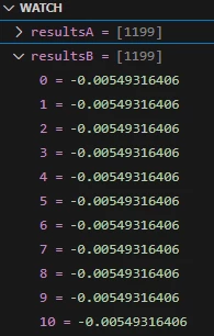

Hello everyone !
I've recently hit a snag in a motor FOC project of mine: the CORDIC unit on a STM32G431xB doesn't give out similar q1.15 results when the input are 32 and 16 bits.
In the current setup, both sine an cosine coefficient are pre-stored as q1.15 values in two separate sensor input buffers (from hall resolvers).
In order to simulate actual q1.31 value, I simply left-shift the buffered q1.15 values by 16 upon use, and tolerates the LSB loss for the purposes of the tests.
Here's an excerpt of the test method :
[main loop]
    float *pResA = resultsA, *pResB = resultsB; // For the purpose of the test, our q1.15 results will be converted to degrees as f32 values.
    cnt = NB_ANGLE_SAMPLES;
    CordicUnit::clearError();
    while (cnt-- && !CordicUnit::hasError()) {
        // Input sin/cos coeffs' are stored in q1.15 buffers, addressed through *pSin and *pCos.
        // Both functions returns q1.15 results
        *pResA++ = 180.0f + 180.0f * ((float)CordicUnit::atan2_i31_o15(int32_t(*pSin) << 16, (int32_t)(*pCos) << 16) / 32767); // fed truncated Q1.31 values.
        *pResB++ = 180.0f + 180.0f * ((float)CordicUnit::atan2_i15_o15(*pSin, *pCos) / 32767); // fed the actual Q1.15 values.
        pSin++;
        pCos++;
[/main loop]
One would expect resultA and resultB contents to vary only by a few percents, however, that's not the case :
results from
atan2_i31_o15
results of CORDIC Phase (atan2) with two Q1.31 iinputsresults of CORDIC Phase (atan2) with two Q1.31 iinputs
results from atan2_i15_o15
Results of CORDIC Phase (atan2) with two Q1.15 inputsResults of CORDIC Phase (atan2) with two Q1.15 inputs
Wut ?

I'm quite at a loss here.
Using either q1.15 or q1.31 inputs isn't a costly time issue, but I cannot fathom why the results differ so much.
Any idea ?

Nothing ? Was my exposé too long ? :confounded_face:
Well, having no response at all, and the CORDIC phase calculations still returning gibberish
I had to implement the CORDIC atan2 on the sensor side ( hosted by a measly CH32V003, but it manages to push out samples at 25Ksps, so I'm not complaining -yet- )
Here's the function code, for those interested : its crude, unoptimized, but gets the job done :
