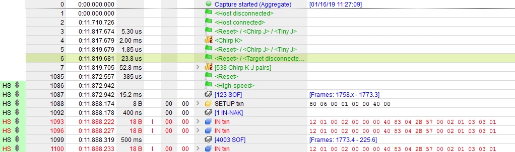

Converting STM32F4Discovery Demonstration to High Speed USB
Been searching, but I can find anything. Most responses refer to the fact that you need the ULPI PHY. I have a USB330 ULPI board plugged. I configured the new pins. If I recall one was shared with the accelerometer so I switched the mouse to be GPIO buttons rather the accelerometer. I did USBD_Init(&hUSBDDevice, &HID_Desc, DEVICE_HS); instead of DEVICE_FS. Note if I use DEVICE_FS the mouse still works. I modified USBD_LL_Init to add:
if (pdev->id == DEVICE_HS) {
// Link The driver to the stack
hpcd.pData = pdev;
pdev->pData = &hpcd;
hpcd.Instance = USB_OTG_HS;
hpcd.Init.dev_endpoints = 6;
hpcd.Init.speed = PCD_SPEED_HIGH;
hpcd.Init.dma_enable = DISABLE;
hpcd.Init.ep0_mps = DEP0CTL_MPS_64;
hpcd.Init.phy_itface = USB_OTG_ULPI_PHY;
hpcd.Init.Sof_enable = DISABLE;
hpcd.Init.low_power_enable = DISABLE;
hpcd.Init.lpm_enable = DISABLE;
hpcd.Init.vbus_sensing_enable = DISABLE;
hpcd.Init.use_dedicated_ep1 = DISABLE;
hpcd.Init.use_external_vbus = DISABLE;
if (HAL_PCD_Init(&hpcd) != HAL_OK)
Error_Handler();
HAL_PCDEx_SetRxFiFo(&hpcd, 0x200);
HAL_PCDEx_SetTxFiFo(&hpcd, 0, 0x80);
HAL_PCDEx_SetTxFiFo(&hpcd, 1, 0x174);
It is seen by the host and enumeration is started, but fails. My Beagle SUB 480 protocol analyzer shows a response, but I think it is at the wrong time.
Any thoughts? I can post more information, but maybe this will be enough.
Thanks in Advance

RobG
RobGAuthor
Jan 16, 2019 4:34 PM UTC
0690X000006D82gQAC.pngIt may be a little hard to read, but I think my issues is the first Setup packet is naked. Anyone?
RobG
RobGAuthor
Feb 4, 2019 2:01 PM UTC
Turns out I did everything right in FW. There was a pin conflict in HW. Thanks for your help.
