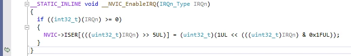

Controller stalls at NVIC_EnableIRQ(CAN_TX_IRQn) after jump to application from a bootloader.
I am using a CAN bootloader to update my application. But after flashing the application and jumping from the bootloader to the reset vector of the app, the program stalls after calling NVIC_EnableIRQ(CAN_TX_IRQn). Is there a problem that the bootloader already used the CAN peripheral?
The bootloader resets and stops the peripheral before the jump.
Controller is a STM32F303RE.
Before NVIC_EnableIRQ is called, the peripheral registers have the following values:
MCR = 0x0001004c
MSR = 0x00000c00
TSR = 0x1c000003
RF0R, RF1R = 0
IER = 0x00008f03
ESR = 0
BTR = 0x012d000f
Update:
I looks like the application calls the old interrupt routine address of the bootloader
 .text.TgtCAN1TXIsr
 0x08009be8 0xc VisualGDB/Debug/target.o
 0x08009be8 TgtCAN1TXIsr

Make sure you correctly configure the Vector Table, via SCB->VTOR, typically in SystemInit()
Don't call from an interrupt/callback.
Have HardFault_Handler and ErrorHandler output useful / actionable information.

Before the jump to the application the bootloader set stack pointer and the vtor pointer, after the start of the application the
SystemInit overrides with the old flash start value 0x08000000.

> ... after the start of the application the SystemInit overrides with the old flash start value 0x08000000.
Then you might need to adapt your application / SystemInit.
Both bootloader and application are supposed to harmonize in this regard.
