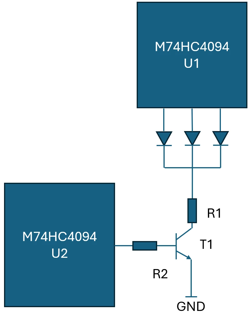

Friends, which algorithm do you use to control the LEDs in this structure? I need your ideas. I have prepared a table of the LEDs' turn on order.

Have you examined the electronic circuit?
for example, what should be the algorithm to turn on led1 led2 led3 and led4?
Because when led1 led2 led3 is active, the (2nd) 74hc4094 integrated circuit on the right has to give cathode information to all leds.
If you turn on led4 while led1 led2 led3 is on, how will you ensure that led5 and led6 remain off?

PS:
It's already been noted that there are no current-limiting resistors in your schematic.
Is that just an omission from the schematic, or are they really not there in the actual hardware?

A lot has already been said in this topic. I'd like to ask a few questions:
  1. What is the purpose of this project? (What are the requirements?)
  2. What are the LEDs connected to? 7 segment displays?
  3. Does each LED have its own current limiting resistor or are those shared by a group of 3?
  4. what strobe rate do you want?
  5. Are glitches in strobing allowed or do you not want LEDS to glitch momentarily?
  6. I see data of second shift unconnected that is not good. How do you intend to control that?
The LED's need to be controlled via strobing if you want to allow all LEDs to be controlled individually (due to persistence of vision at sufficient strobing rates). Otherwise you cannot get all combinations working.
In this case you have 8 groups of 3 (or 3 groups of 8 depending on how you see it)
So I would implement the algorithm the following way:
  • set LED selector to 100
  • set group selectors to 1 for each group that has first LED on
  • delay T/3
  • set LED selector to 010
  • set group selectors to 1 for each group that has second LED on
  • delay T/3
  • set LED selector to 001
  • set group selectors to 1 for each group that has third LED on
  • delay T/3
  • repeat
If you don't want any glitch you need write zeros to one of the shift registers prior to changing (dead time) the other or daisy chain them and Latch them synchronously (no overlap).
The LEDs that need to be on are only on 1/3 of the time. For instance for 333us if you want a strobing rate of 1kHz. So you need to increase the current. If 10mA is the desired continuous current you need to use 30mA. But check the datasheet for maximum pulsed current for the LEDs.
You can use a loop and simple bitshifting to check which group has an LED on. You can store all LEDs in a single uint32_t led_states . group_state[x] = led_states & 1<<(x*3+led_shift)
I don't think that's true?
I think one 11-bit pattern can be used to turn on any number of LEDs - including all or none?
@XooM show the full schematic - transistor, all resistors, etc - for one group of three LEDs
Or confirm if @mƎALLEm guessed correctly with this:
Is there really only one R1 per group of 3, or is there a separate series resistor for each LED ?
unsigned_char_array
Lead III
Nov 20, 2024 2:57 PM UTC
The groups are connected in parallel. So you cannot have:
LED0: 1
LED1: 0
LED2: 0
LED3: 0
LED4: 0
LED5: 1
simultaneously.
Because group 0 has LED0 on and group1 has LED3 off and group0 has LED2 off and group1 has LED5 on. Since both groups have active LEDs they need to be selected.
With strobing it is possible because the eyes see fast pulsed LEDs as on. Either in 8 steps of 3 or 3 steps of 8. The latter is quicker and requires less peak current.

@XooM What is driving you to use this board - which, apparently, has inadequate documentation and no support??

Friends, I will give you the document you want in a moment, but I do not understand how this forum works. In the country where I speak my own language, we can understand what we mean very quickly without giving too much detail. Here, people either have poor electronics knowledge or want to know everything.
I just made a simplified drawing to ask for help from the algorithm.
The missing parts are not relevant to the question I asked.
I assumed that everything was complete and wanted to talk about the algorithm. There is no deficiency or error in the design of the circuit. The circuit is an actively working circuit.
Since every programmer has a different perspective, I asked to learn your perspective on the event.
I will explain the missing parts of the circuit and my own coding in a way you can understand.
I will share it in 30 minutes.

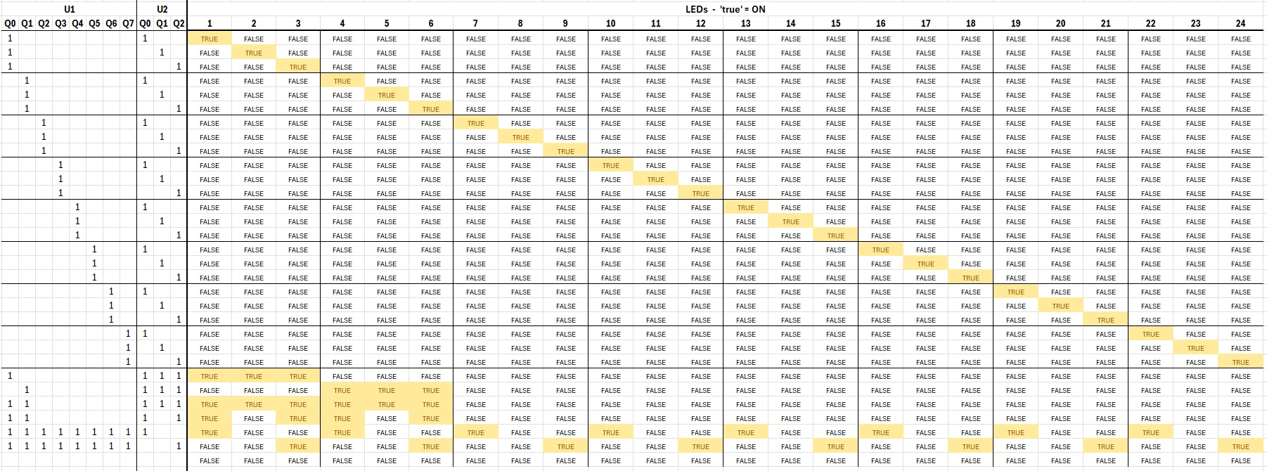

I made a spreadsheet to investigate possible combinations of LEDs:
