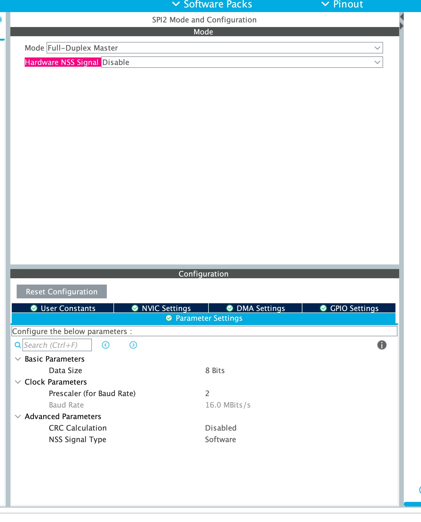

The one weird thing I notice is that the MX config for this project doesn't have options for the SPI data format like normal (motorola, MSB first). Is there anything that could be going on in that regard?

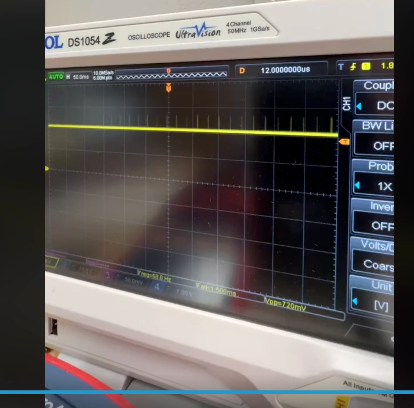

    One thing we have found however is that the clock signal looks strange on our oscilloscope. It appears to be written fully high with small blips above 3.3V during write periods:
    Is there anything in MX setup that might account for this?

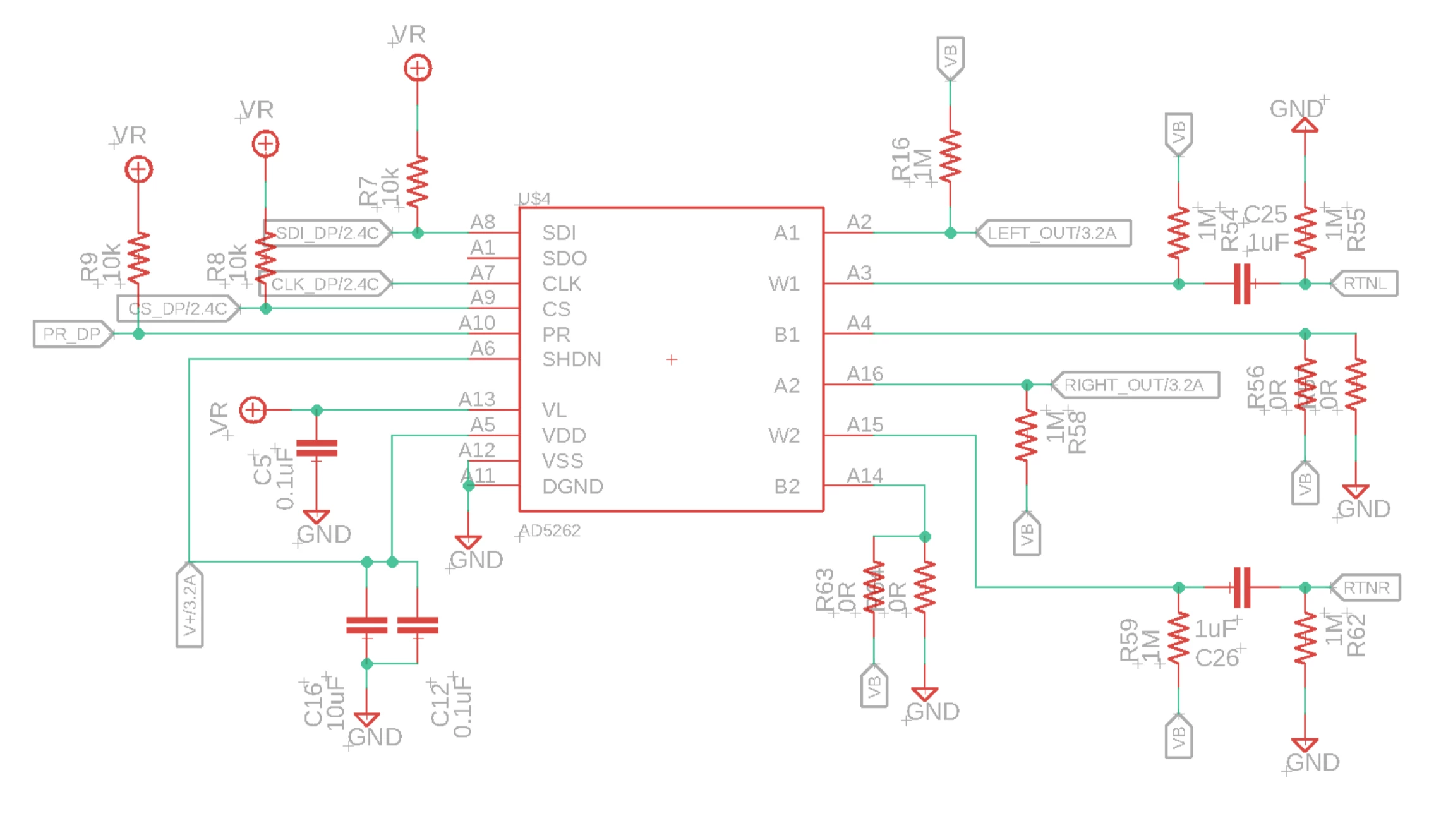

    This is our schematic for the digital pot:

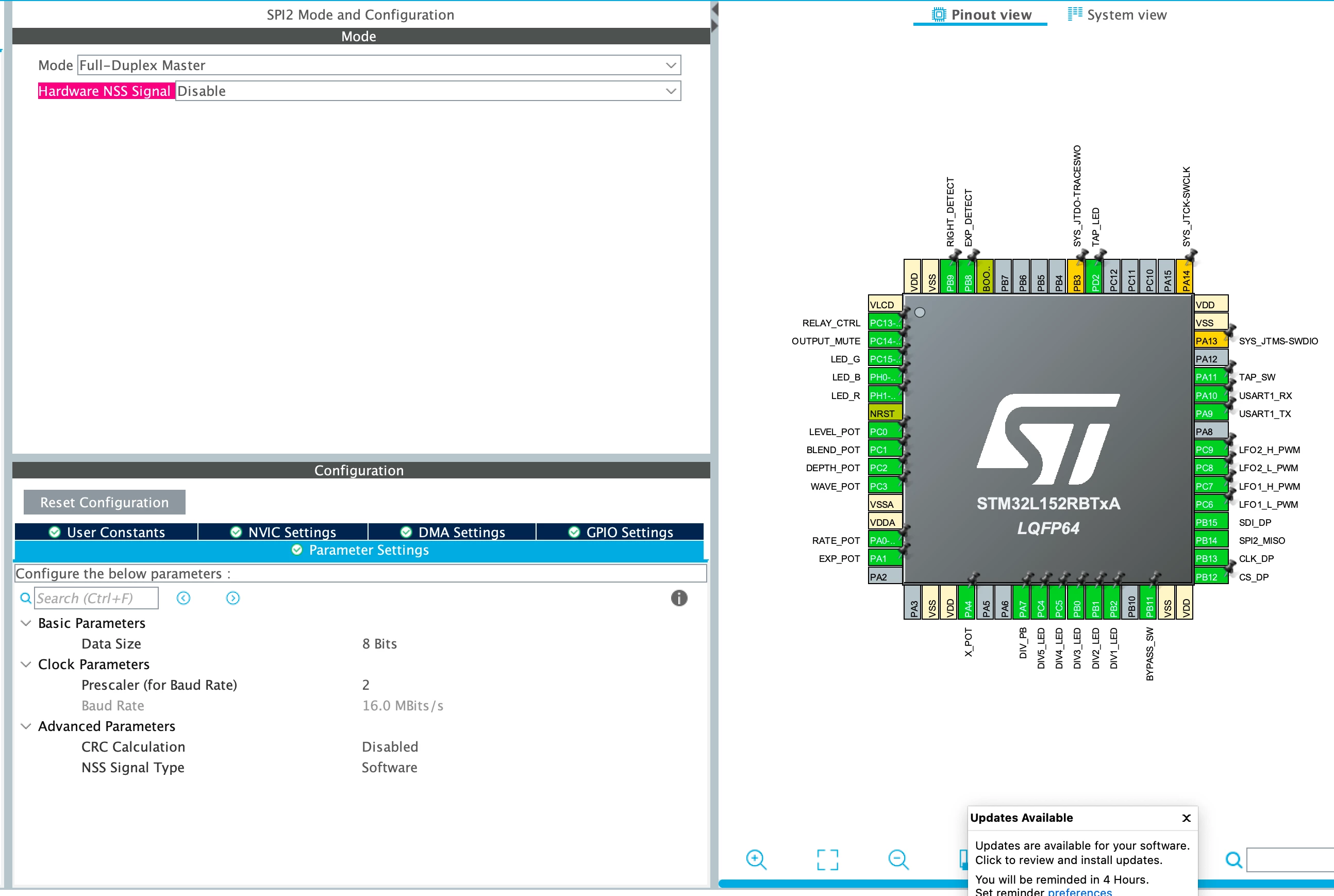

    This is our MX config:
    Jan 10, 2024 1:16 AM UTC
    If SCK is always high, even when it should be sending clocks, yeah that's the problem, or at least one of the problems. There's no CubeMX setting to do this, it's likely a hardware fault.
    I wouldn't worry too much about the noise, at least not if SCK is otherwise behaving normally. Is something happening in your system at ~200 kHz?

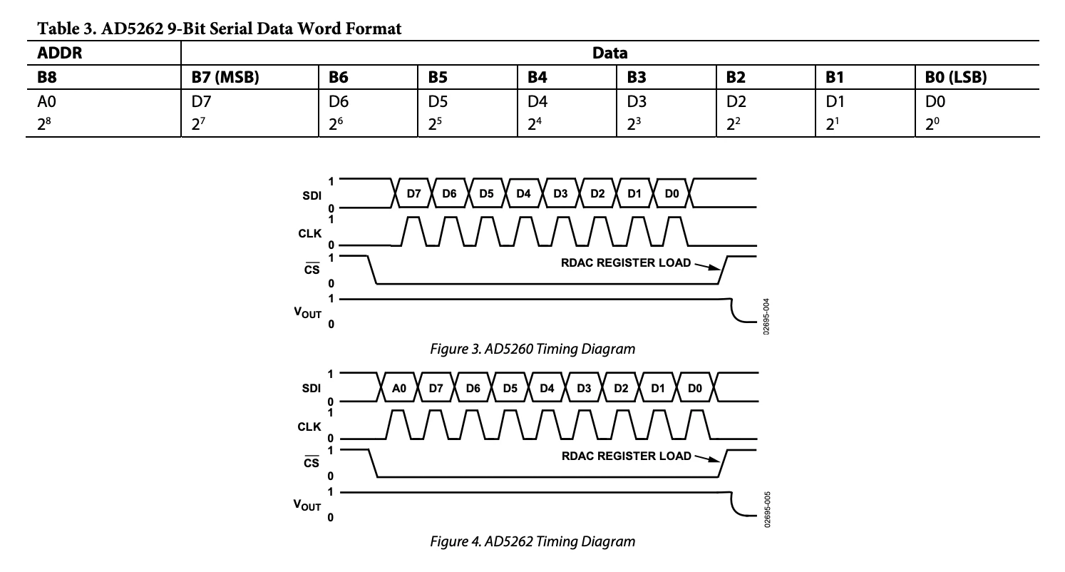

    Analog Devices is a serious company, they don't employ ****s. Of course they considered SPI controllers that can only send whole bytes.
    The document says clearly: "For the AD5262, the last nine bits of the data word entered into the
    serial register are held when CS returns high. Any extra bits are ignored. " (page 15). The MSBit goes out first. So, just output 16 bits where your 9-bit data is aligned to the right (LSB goes out last).

    Hmmm... could you explain how the code example you sent matches up with what's described in the datasheet?
    Your example appears that is would send out the wiper value then the address bit, whereas the datasheet clearly shows the address bit coming first:
    I think the main question here is whether the extra zeros should come before or after the 9 bit word. Can you clarify that?
    	spi_block[0] = (pot << 7) | (val >> 1); //zeros after data
    	spi_block[1] = val << 7;
    //	spi_block[0] = pot;						//zeros before data
    //	spi_block[1] = val;
    It sounds like maybe you are saying the zeros go before the data, but have the order of the SPI blocks reversed in your example?
    Pavel A.
    Jan 10, 2024 9:13 PM UTC
    Yes ,  the zeros go before the data. I can be wrong with the bytes/bits order. The STM32 Ref. Manual shows that bits on SPI interface go out from MSB (first) to LSB (last). The last 9 bits of 16 do matter. Thus I defined the array so that the significant bits are LOW - assuming that the SPI data size is 16 bit. You've got the idea. You can set the SPI data size to 8 bits as well.  Please use a logic analyzer to check what actually goes onto the wires.
