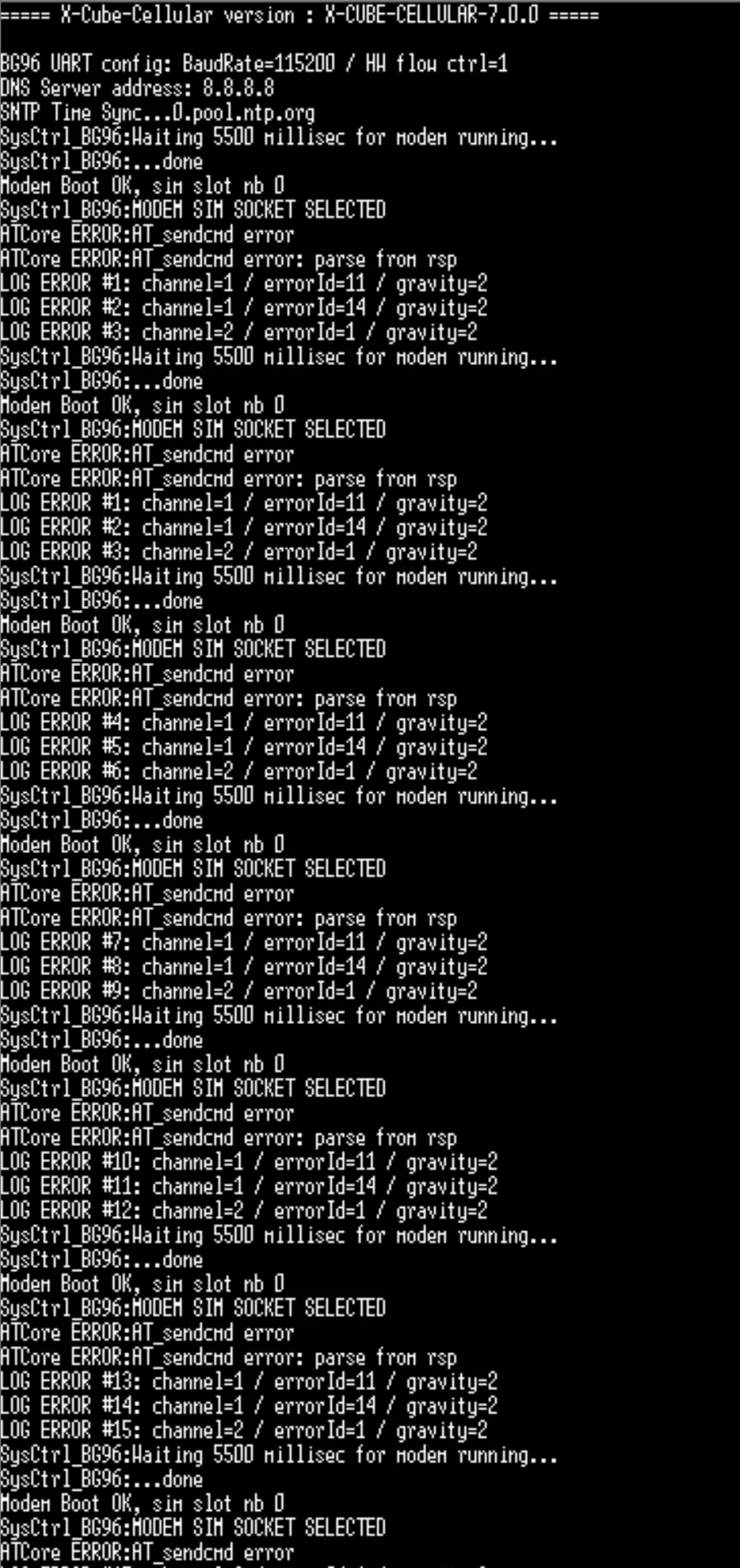

Connection Problems with Nx_TCP_Echo_Client
hello
We have some problems to run the "32L496GDISCOVERY\Nx_TCP_Echo_Client" from the "STM32CubeExpansion_CELLULAR_V7.0.0" package (with AZURE RTOS).
What we did so far: we changed the entries in "plf_cellular_config.h" to meet the requirements of our SIM card provider (APN, username, password).
Than we built and deployed this project (successfully) to our P_L496G-CELL02 board with Tera Term attached to the VCP of the eval board.
What we see here is the folowing log:
===== X-Cube-Cellular version : X-CUBE-CELLULAR-7.0.0 =====
BG96 UART config: BaudRate=115200 / HW flow ctrl=1
DNS Server address: 8.8.8.8
SNTP Time Sync...0.pool.ntp.org
SysCtrl_BG96:Waiting 5500 millisec for modem running...
SysCtrl_BG96:...done
Modem Boot OK, sim slot nb 0
SysCtrl_BG96:MODEM SIM SOCKET SELECTED
ATCore ERROR:AT_sendcmd error
ATCore ERROR:AT_sendcmd error: parse from rsp
LOG ERROR #1: channel=1 / errorId=11 / gravity=2
LOG ERROR #2: channel=1 / errorId=14 / gravity=2
LOG ERROR #3: channel=2 / errorId=1 / gravity=2
LOG ERROR #4: channel=1 / errorId=11 / gravity=2
LOG ERROR #5: channel=1 / errorId=14 / gravity=2
LOG ERROR #6: channel=2 / errorId=1 / gravity=2
If we enter the "cst state" comamnd into TeraTerm, we see, that APN, username and pasword have been set correctly.
What could cause this behaviour and these error messages? What are we doing wrong?

because there is no answer to my problem yet, i will aks a more specific question:
What is the meaning of the error messages that I see on my terminal?
And what causes them?
I mean these errors:
LOG ERROR #10: channel=1 / errorId=11 / gravity=2
LOG ERROR #11: channel=1 / errorId=14 / gravity=2
LOG ERROR #12: channel=2 / errorId=1 / gravity=2

Jul 26, 2022 1:58 PM UTC
Dear Michael,
Such Error is returned when the Modem does not answer to the AT command.
So, either the Modem is busy, for example to search network or other ongoing task, or the communication with the Modem is not longer operational.
To get more detail, can you please enable the trace to get more information?
For that in the file plf_sw_config.h
you can set trace flags as defined below. Then share the log for further analysis?

Jul 27, 2022 6:06 AM UTC
Hi Solofo
Thank you for your answer. If I enable the traces you mentioned, I get the attached log (LogCellularDemo_01.txt).
There seems to be an issue with the SIM?
--> But if I run the Cloud_AZURE_V1.2.1 demo on the same eval-board (P_L496G-CELL02) with the same APN settings, it works fine:

I am also facing the same issue with Nx_TCP_Echo_Client. After the modifications in the file plf_sw_config.h, it can be vividly seen that the error is of SIM FAILURE because AT+QCCID command is unable to provide any response in STM32CubeExpansion_CELLULAR_V7.0.0.
But if we use other firmware "STM32CubeFunctionPack_LTE1_V1.1.0" use the AT+QCCID command its working fine. The SIM is connecting to the network and able to provide feedback.
To sum up, the issue is in "STM32CubeExpansion_CELLULAR_V7.0.0" application.

Jul 28, 2022 2:29 PM UTC
Hello Michael and Al,
Based on the log you have shared, the Modem FW is old BG96MAR02A06M1G and the new version of X-CUBE-CELLULAR needs BG96MAR02A08M1G. In fact, the X-CUBE-CELLULAR starting from 6.0.0 it will automatically select the APN based on the inserted SIM card. So, it needs to read the ICCID and IMSI while the Modem is in AT+CFUN=4 (RF not used).
So, to use the X-CUBE-CELLULAR, you have to update the Modem FW.
The procedure to update Modem FW is available in the X-CUBE-CELLULAR V6.0.0 and you can find the material at STM32CubeExpansion_CELLULAR_V6.0.0\Utilities\Modem_FW\BG96\.
The Quectel Tools (QFLASH, Drivers, ..) can be downloaded here https://www.quectel.com/ProductDownload/BG96.html
Best Regards

Aug 11, 2022 11:46 AM UTC
hi all, hi Solofo
Short information:
I finaly managed to update the BG96 firmware to BG96MAR02A08M1G and now the Echo_Client demo works fine.
But:
This was only possible with help from Quectel because the folder- and file-structure in the firmware .ZIP (BG96MAR02A08M1G_01.012.01.012.zip) provided from STM in the X-CUBE-CELLULAR V6.0.0 extension is completeley wrong and will never work in QFlash according information from the Quectel supporter.
