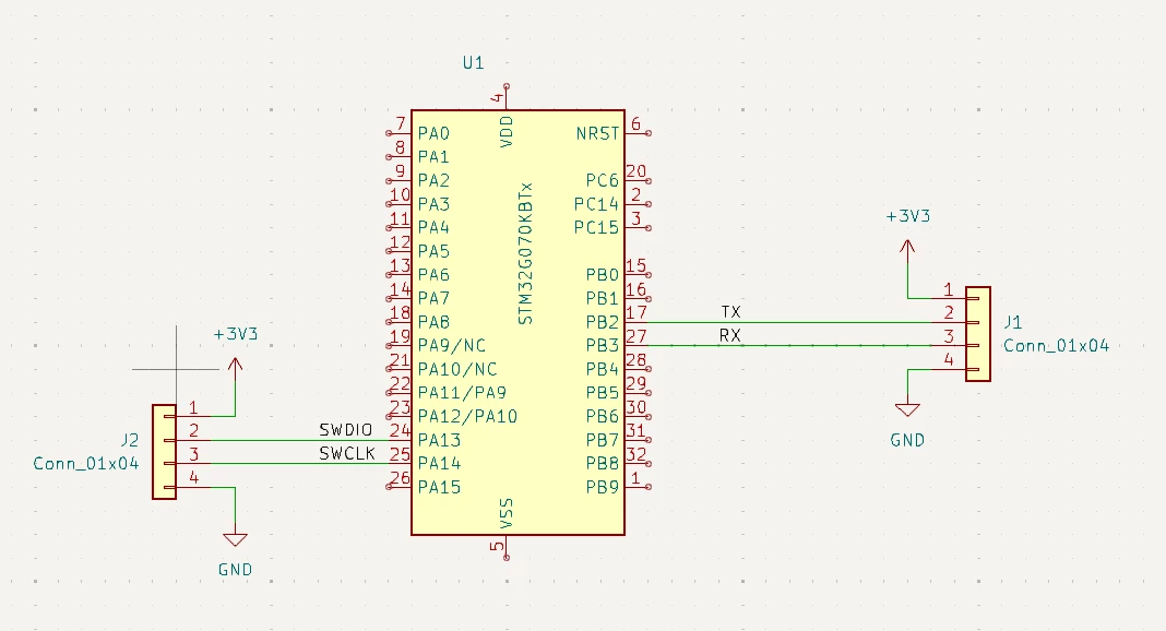

Hello guys,
I am trying to make a development board using STM32G070KBT6 MCU, I want to add two modes to program flash memory
1. UART
2. SWD
but the PA14-BOOT0 share a common pin, I have looked online for suggestions but am a bit confused now, can anyone give a final solution if I want to use both UART and SWD to upload code and a bit reference on how to do it
if I have to add a circuit part or change bits, I only want these to upload code to my MCU.

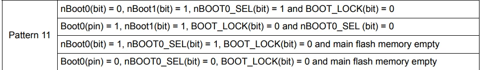

Aug 13, 2024 4:17 PM UTC
You can use any of the Pattern11 propositions to go to boot mode:
So, you can use the first one that does not need to use the boot0 pin.
PS: STM32G070x devices do not have BOOT_LOCK (bit), consider that when using Pattern 11.
Best Regards.

Aug 13, 2024 4:35 PM UTC
@STTwo-32 @MM..1
Hey guys for the final verdict that I understood everything, I selected the nBoot0(bit)=0,nBoot1(bit)=1,nBoot0_SEL(bit)= 1 and BOOT_LOCK(bit)=0 from the cube programmer and then I can use both the programming option UART and SWD without worrying about the Boot0 pin.
I have also attached the schematic just for these programming interfaces, also suggest if I have to add anything related to programming.
STTwo-32
Aug 13, 2024 4:40 PM UTC
Yes
