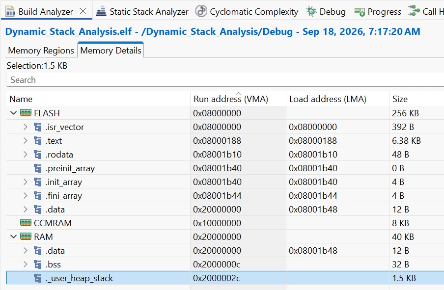

I’ve been discovering the different views available in STM32Cube IDE and among them is the Build Analyzer view.
In this view I found a section in the RAM called ._user_heap_stack.
I searched for it in the linker script and found that it corresponds to the following section :
/* User_heap_stack section, used to check that there is enough "RAM" Ram type memory left */
._user_heap_stack :
. = ALIGN(8);
PROVIDE ( end = . );
PROVIDE ( _end = . );
. = . + _Min_Heap_Size;
. = . + _Min_Stack_Size;
. = ALIGN(8);
} >RAM
With
_Min_Heap_Size = 0x200; /* required amount of heap */
_Min_Stack_Size = 0x400; /* required amount of stack */
In Figure 1, one can see that the start address of the ._user_heap_stack is 0x2000 002C. This means that the last address of the stack should be 0x2000 002C + 200 + 400 = 0x2000 062C, with the 8 byte alignment that would make it 0x2000 0630.
Figure 1 : Screenshot of the Build Analyzer View

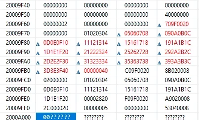

Now what I expect is that at the start of the program (main), the stack pointer would point to this address, i.e. 0x2000 0630.
However, I found that it points to 0x2000 A000 as shown in Figure 2 which is a screenshot from the debugger console.
Figure 2: Screenshot from Debugger Console with Information about Main’s Stack Frame
I called other functions from main and I found that indeed the stack grows downwards from 0x2000A000. I opened the Memory Monitor view to verify that it is true, which you can see from Figure 3.
Figure 3 : Screenshot from Memory Monitor View Inspecting the End of the RAM Section
If we refer back to the build analyser view in Figure 1, we find that this corresponds to the last address of our RAM (start address is 0x2000 0000, size is 40KB = 0xA000, so end address is 0x2000 A000).
