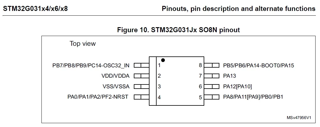

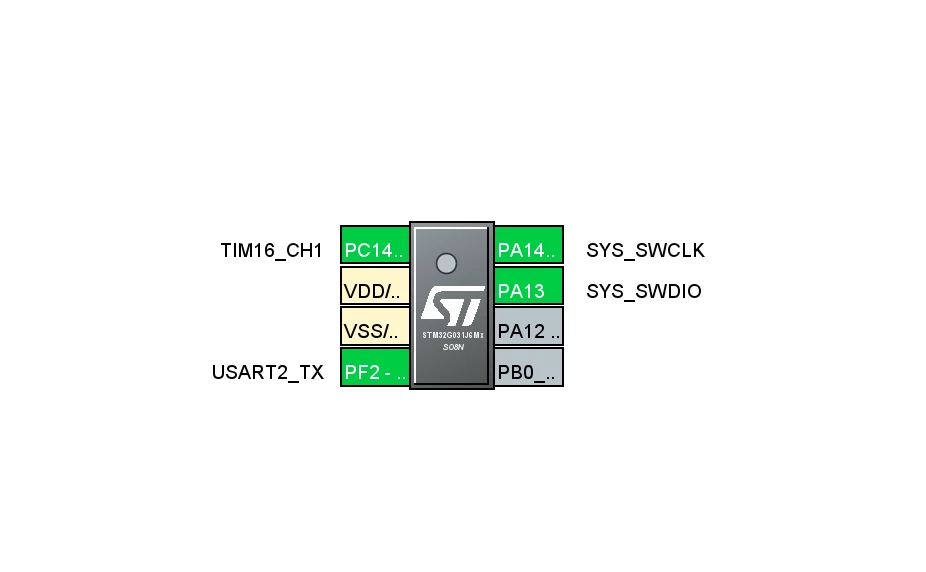

Hi there!
i start to work at one project with STM32G031J. Soo my i have this problem one of the pin is use for reset when i download the program at the same time is configurate a single wire half duplex , and
- i can't simulate
- and it's look like every time i send out data they reset the CPU
Some one can help me

Interesting issue. From the datasheet:
possibly being the most opaque and least helpful footnote imaginable. "Particular care", wtf does that mean? (sigh middle-school typos in technical writing from multi-billion $$$ multi-national. can't they afford a spell-checker?)

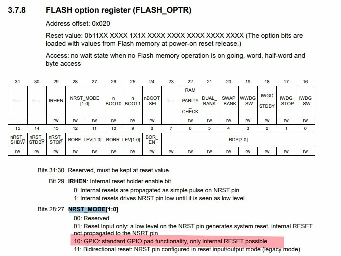

As DeLorean foretold, the RM documents the option bytes:
So it's not enough to assign an AF to the pin in CubeMX, you also have to set the option byte to incapacitate the nRST logic.

I suppose there's a way to change to utilization of the NRST (Pin 4), either on-the-fly, or via the Option Bytes. Cube might not do it for you, but probably coved in the Reference Manual, etc
