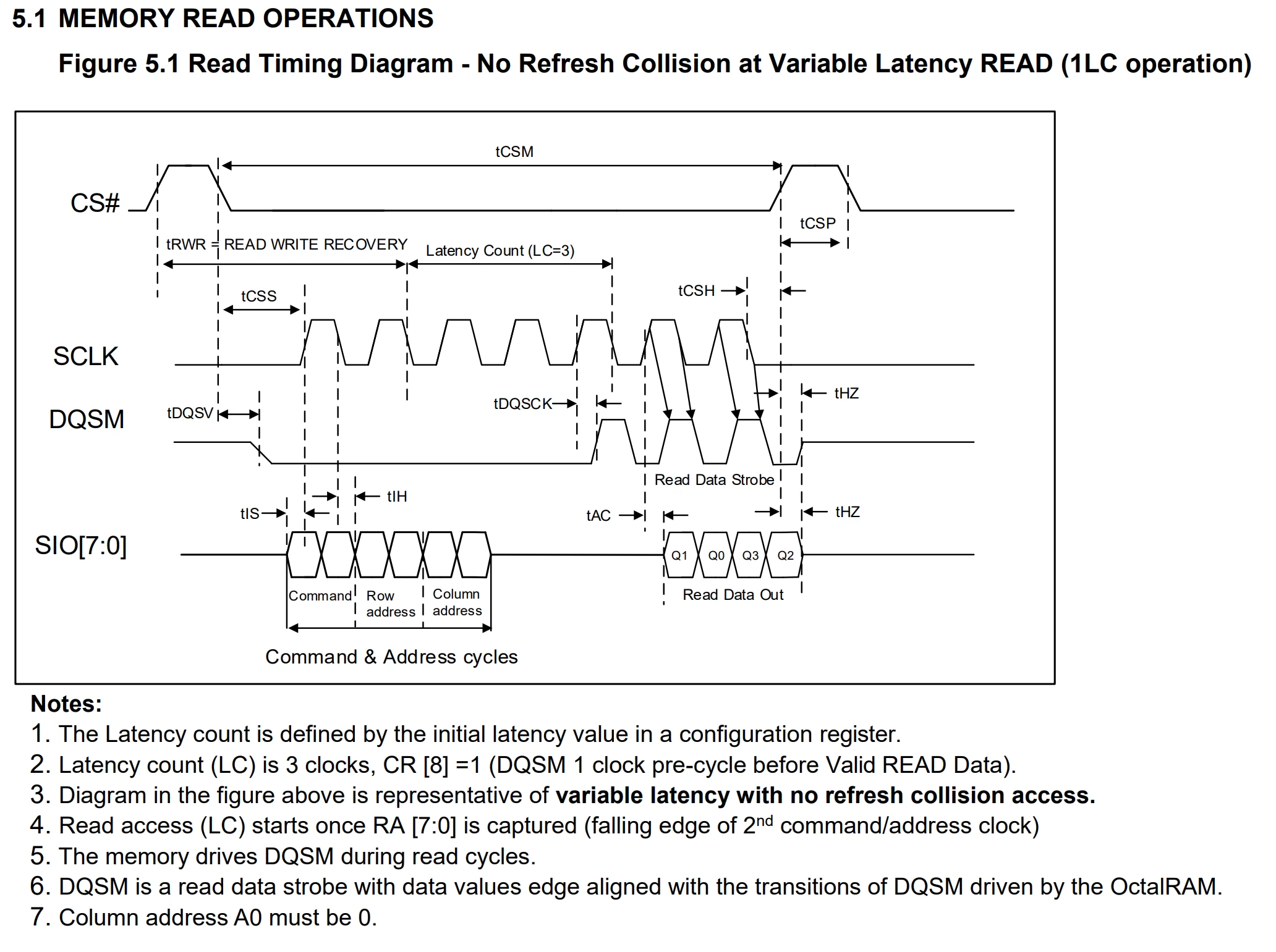

I am not even sure what the right dummy cycles would be to be honest. Based on this diagram from the datasheet I would have assumed 3 dummy cycles
But changing the MX_EXTMEM_MANAGER_Init() to 3 dummy cycles didn't solve the issue. I brute force stepped through dummy cycles (left read and write at the same number of cycles) and found 7 to be the magic number. less than seven and more than seven results in several bits or bytes not being written or read correctly in my test sequences. How to derive the seven from the ISSI datasheet is however a mystery to me.

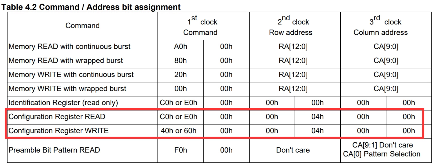

Thanks for the hint about the config register. The numbers currently written there are probably a left over from late night experiments. I did realize now that changing them does pretty much nothing. However, being conscious that the next EMM update will make them work, I would like to set them correct.
Based on the table below from the datasheet do I assume correct that the REGAddress would be 0x04?

To add some context to your solution and generalize it a bit, we had similar difficulty solving this exact problem for the IS66WVO32M8DALL (the 256Mbit version of your device). In short, on this particular memory it is necessary to mismatch the memory's configured latency count and the MCU dummy cycles. The MCU setting must always be 1 less than what is configured in the memory's configuration register. See our findings summarized below:

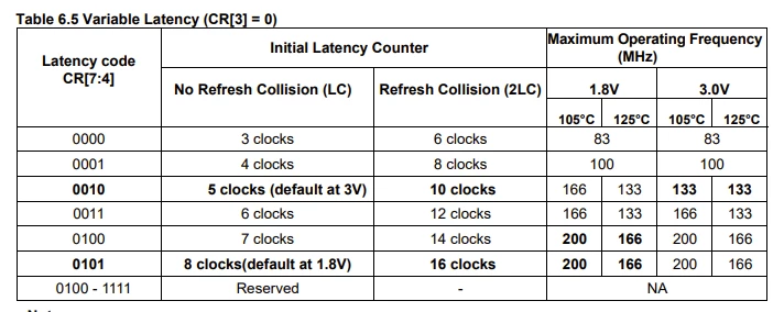

At 1.8V, your default latency count (LC) (applied to the configuration register CR[7:4] of the IS66), is 8. This is shown in Table 6.5:

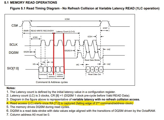

The reason that 7 dummy cycles set on the MCU side works in your case is indeed difficult to determine from the datasheet, but there is a key piece:
"4. Read access (LC) starts once RA [7:0] is captured (falling edge of 2nd command/address clock)"
For this device, the latency count begins before the address has been fully transmitted. In particular, one latency  cycle overlaps with the address transfer (marked by the vertical red lines added to the diagram):
This isn't the case with other devices, and as a result the MCU dummy cycle setting must be one less than the setting applied to the IS66 configuration register to compensate. I'd be willing to bet that for your IS66 configuration, you're currently using the default 8 dummy cycles, and 7 dummy cycles works because it is one less than this setting.
Additionally and for what it's worth, it's very likely that other configurations will work in the same way. E.g. 7LC on the IS66 would work with 6 dummy cycles on the MCU side, 6 with 5, and so on, barring any other issues that limit you from using certain LC settings.
The same would go for fixed latency. Using the default 8LC and configuring Initial Access Latency as fixed (IS66 CR[3] = 1), the effective LC setting becomes 2LC (16 in this case) for memory read, memory write, and register read (per table 6.6 in the datasheet). Therefore a dummy cycle setting of 15 on the MCU side would produce a valid configuration in that case.
Hope this sheds more light on the issue and provides a bit more flexibility in your design.

In order to update Configuration register, you need to use Address = 0x00040000 with 16 bits INS 0x4000 for Write and 0xC000 for Read, if I'm right.
