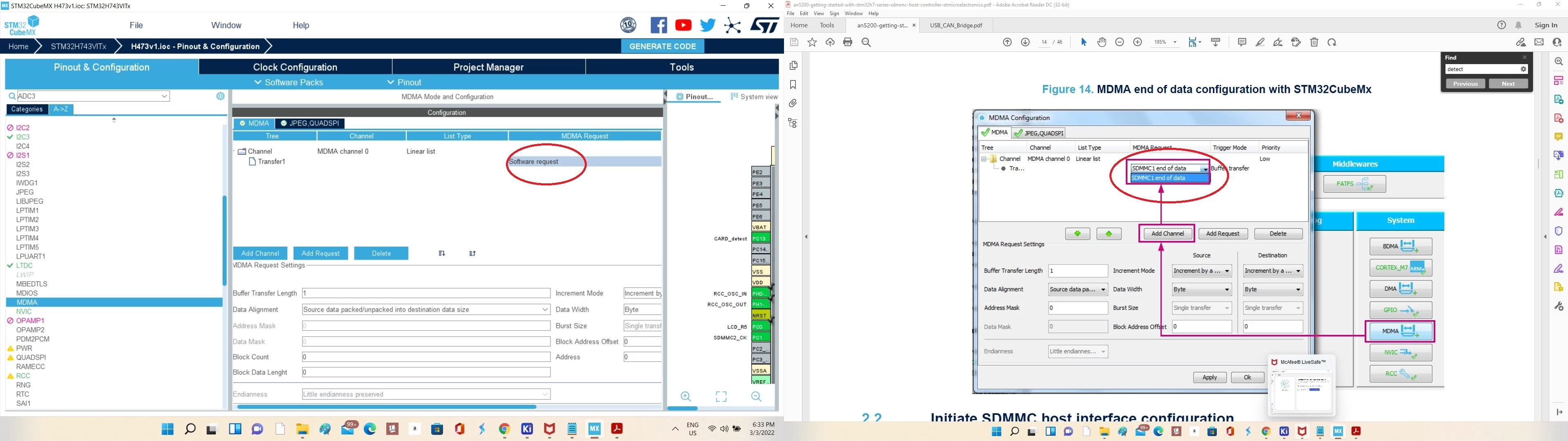

ksale.1
ksale.1Author
Senior II
Mar 3, 2022 4:43 PM UTC
Thank you @Bouraoui Chemli​ ,
Please note the slight difference between AN5200 MDMA config and my CubeMX MDMA, as shown in figure below:
0693W00000KbJifQAF.jpgBR
