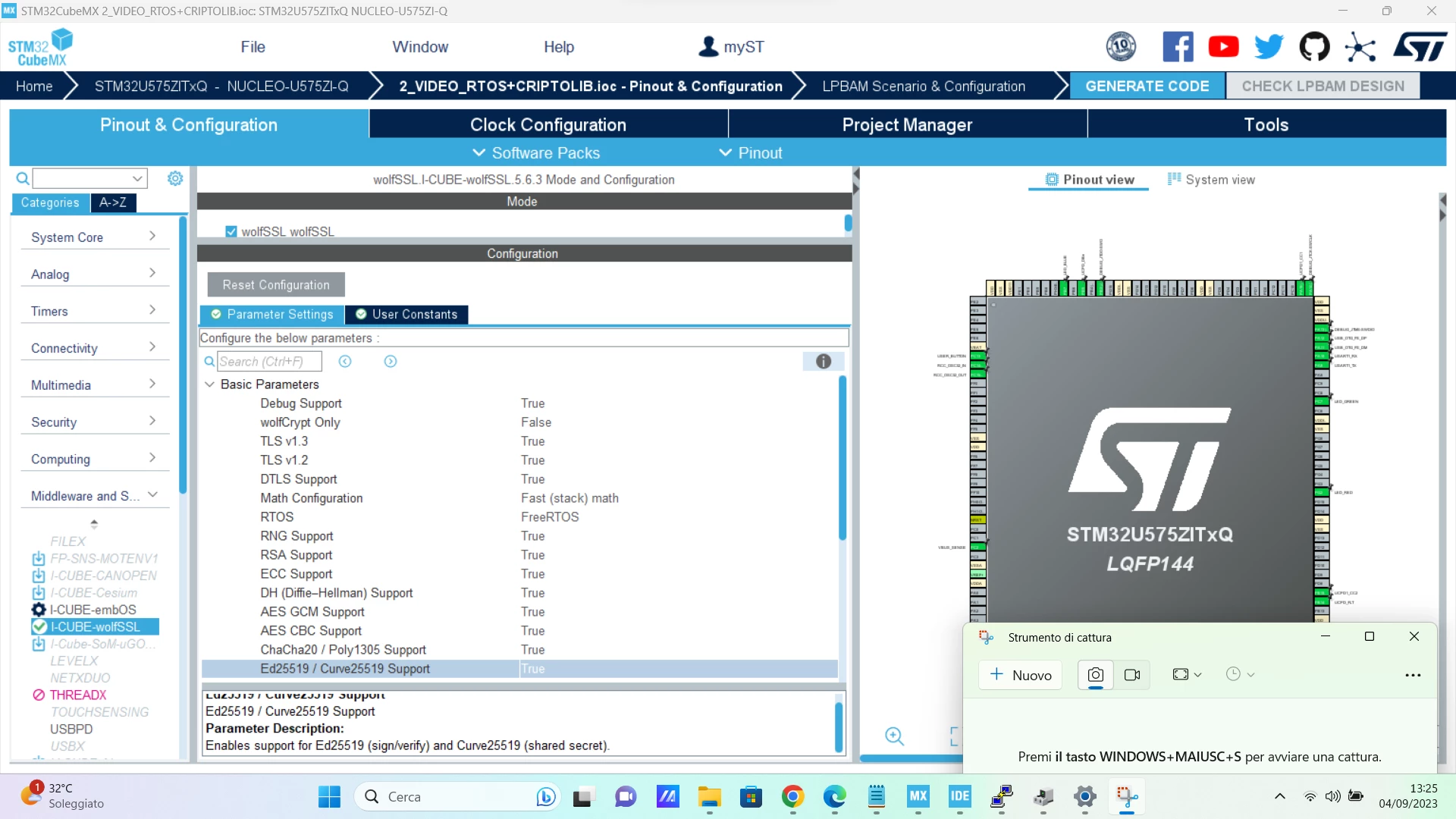

Hi STCommunity,
I have a project with X-CUBE-FREERTOS and it worked fine, since I added WolfSSL the build goes wrong because it doesn't seem to recognize "time_t". (registration file attached)
I hope someone can help me. Many thanks in advance

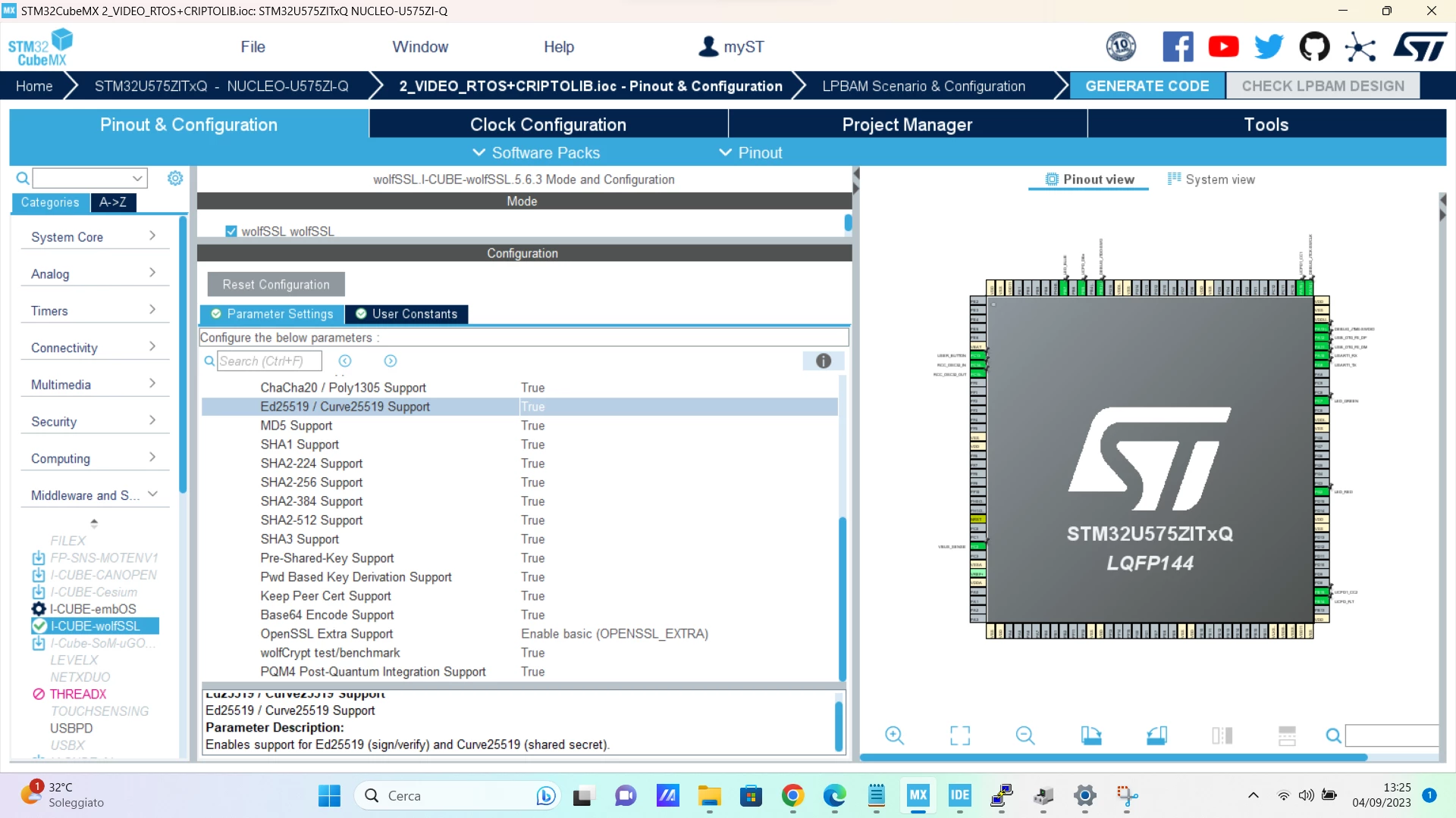

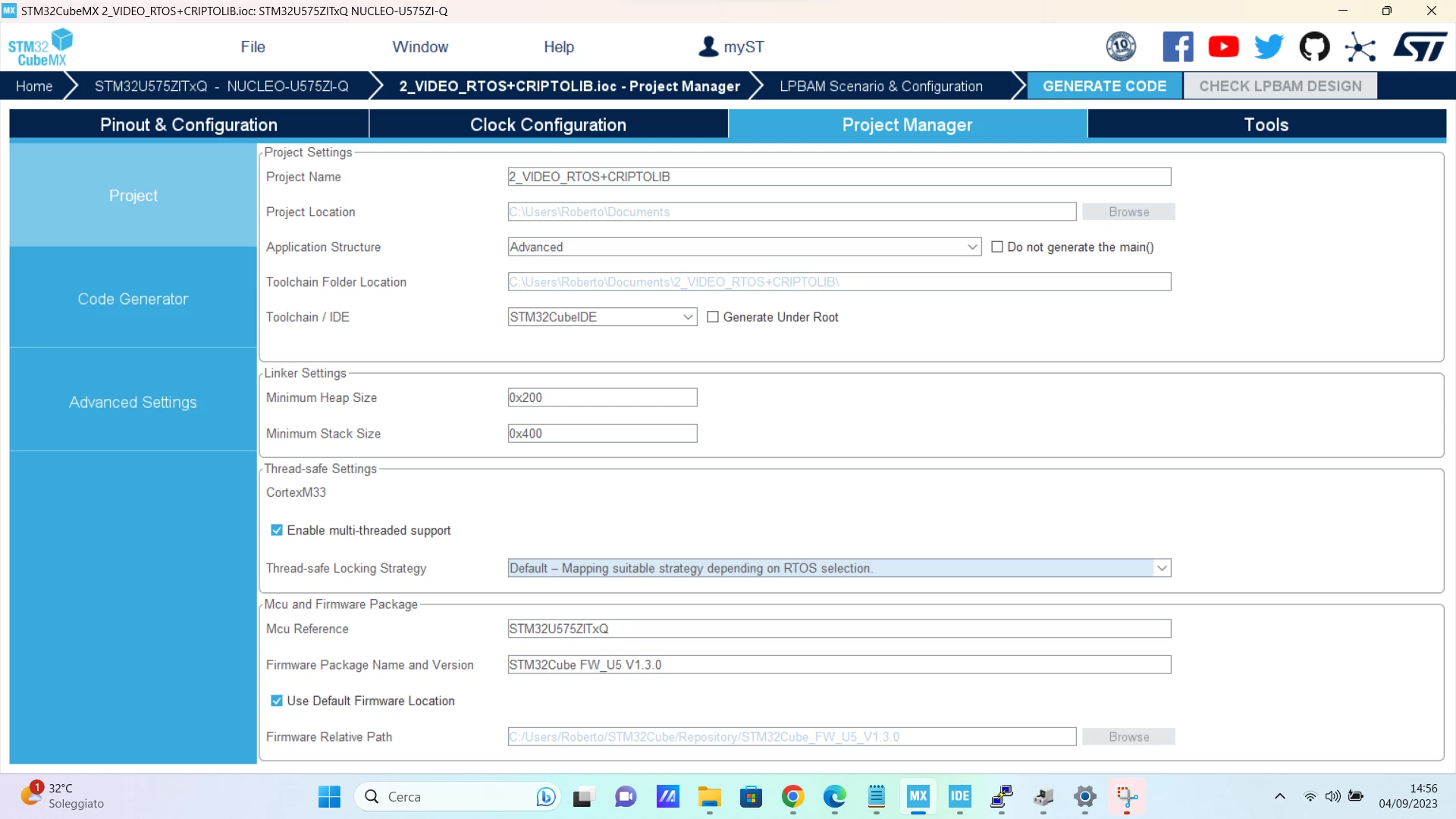

rdlAuthor
Sep 4, 2023 1:52 PM UTC
hi Issamos ,thanks for the fast feedback.
I use STM32CUBEMX 6.9.1 AND STM32CUBEIDE 1.13.1 ON WINDOWS 11 PRO.
I attached  2 screnshot where you can see how I setted wolfSSL parameters.I had attached file .ioc producted by STM32CUBEMX too but it was removed because the format isn't supported as well as for file .zip of project folder

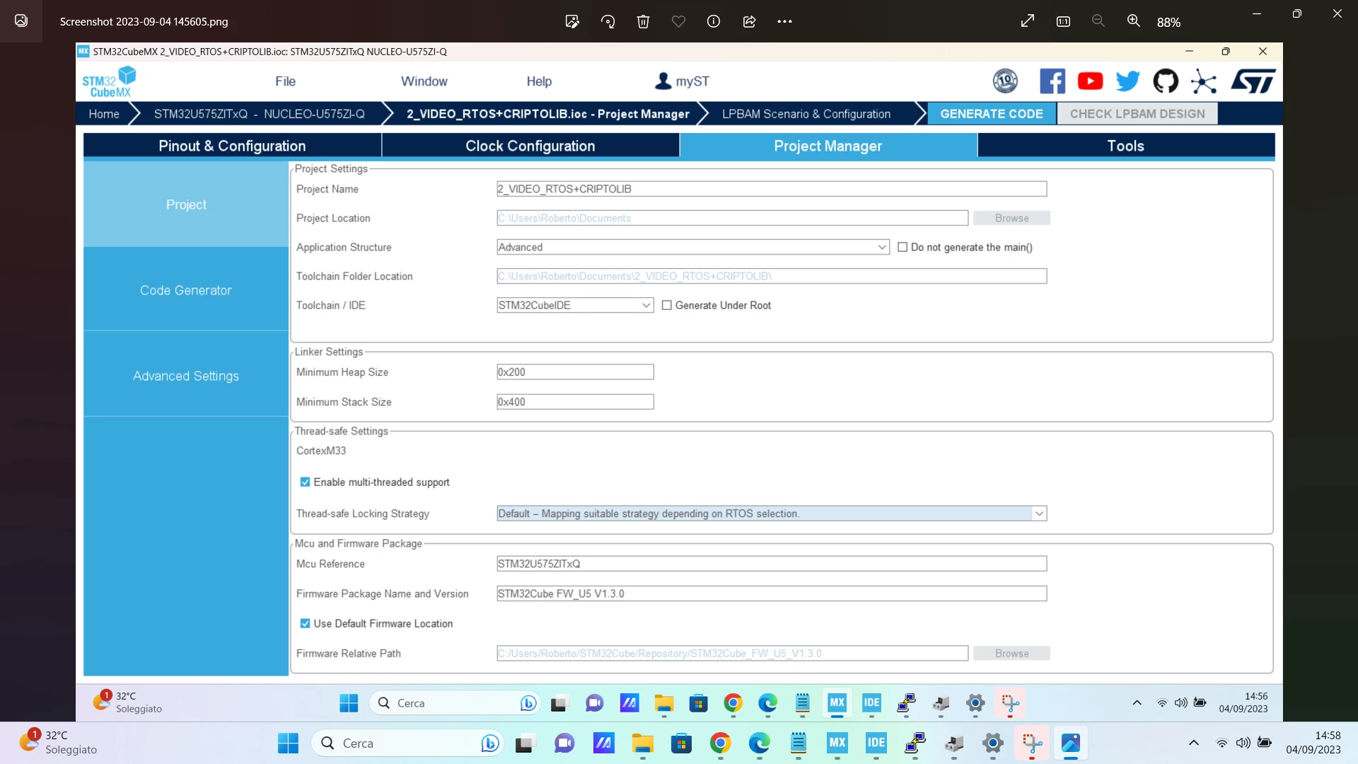

rdlAuthor
Sep 4, 2023 2:59 PM UTC
I've forgot to write I use STM32 Nucleo-144 development board with STM32U575ZIT6Q MCU.I attach others screenshot

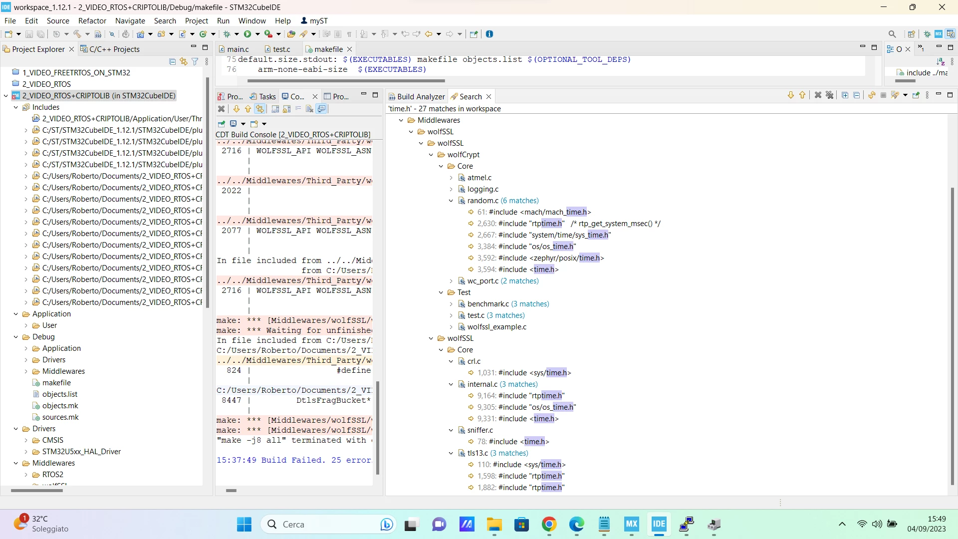

rdlAuthor
Sep 4, 2023 4:05 PM UTC
sorry but i'm novice and the one file ora.h i know is an oracle file header.
I know time_t type defined in file time.h but wolfSSL have to include if it use time_t.
I've attached screenshot where you can see which are the files wolfSSL with include<time.h>
Best Regards
